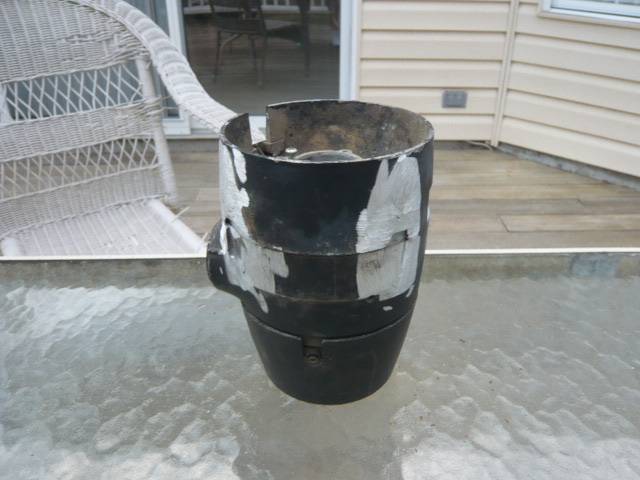

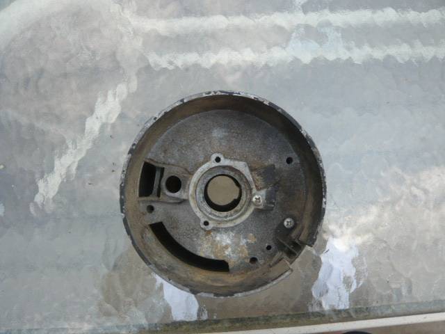

yep Im bored ,yes you can buy them at Tonys mopar for $165. Starting to hate 1970 :lol:

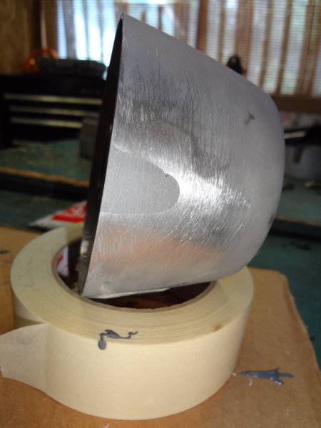

Im going to use bondo.
:thumbsup: sweet job,what year column?

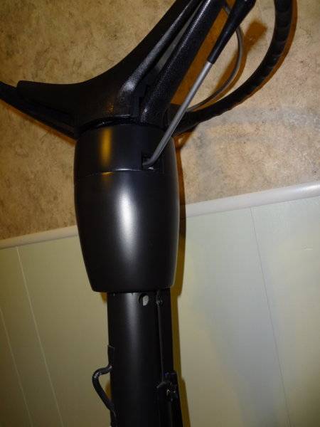

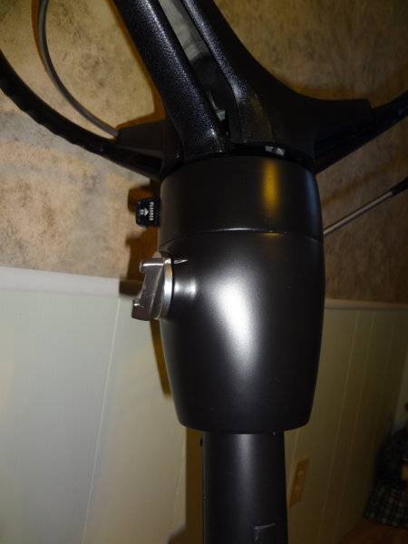

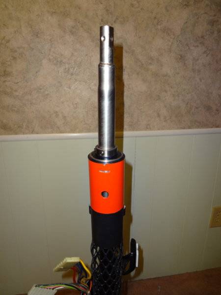

thanks Its a 70 ps column, I removed the interlock and jb welded the bottom collar to the middle one, modified the shaft to fit a u joint for my rack and pinion, has a real bearing on the end,
here is the only other pics I have of it finished.
