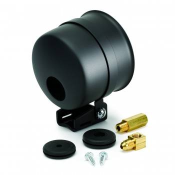

Wondering how this AutoMeter 3-3/8" tach mounting cup #5204 would mount to my 69 B-Body shift-on-the-column steering column without interference? Anyone try it? Would it need modified? Looks like it accepts a hose clamp or zip tie? Pics anyone?

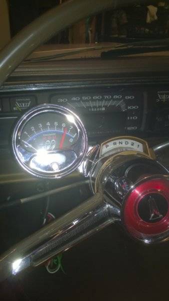

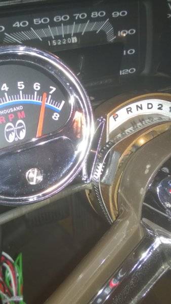

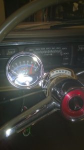

Here is a shot of mine on my column shift. I made an aluminum foot for the mount, attached it to the tach, then hose clamp to the column. I made sure that I could use the turn signal as I mocked it all up. Hasn't moved in 2 years of driving so its ok. The foot of my tach is a bit different than yours but maybe gives you an idea. I can send you more photos if you like, just ask and I can get a better angle.

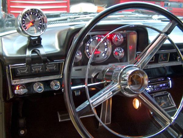

Here's a work-around for a friends C-body that I came up with. It does not touch the dash cap and is secured to the underside of the cap where there is metal.

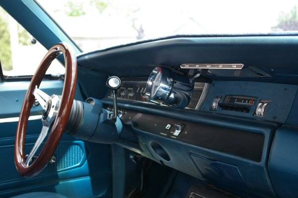

it's been some years back but I had an autometer tach mounted on the column of my '69 r/t. I used the autometer mount and clocked the tach somewhere between the 1 o'clock-2 o'clock position. I had an oil pressure gauge mounted to the left, about 10 o'clock position. this worked for me for years.
