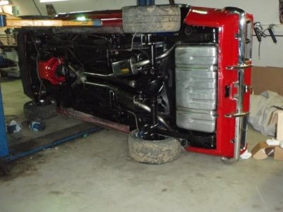

Oh definitly operator error. Doesn tlook like the lifts failed (except for that last 4 post ) All tipped off. Gotta say im glad the first one is a camaro hahahahaha

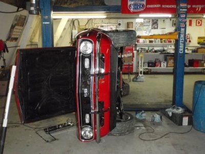

How about that Craftsman lift, definitely looks like a failure when there's no arm visible on the other side.
Good eye 747, i was too excited and distracted by the sideways camaro, i hate camaros....
If you look closely you can see the yellow of the missing arm on the ground by the camaro that looks like a fail the rest look like idiot error

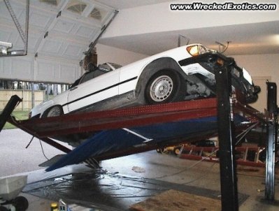

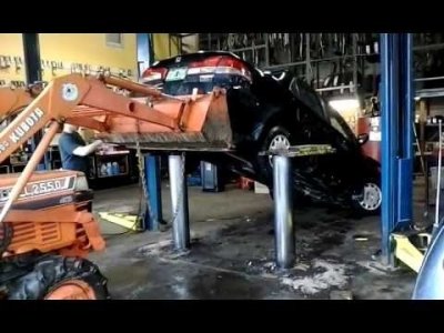

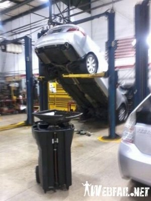

Some of those may have been not locked properly and left on the hydraulics over night and drained down. The Camaro looks to me like it was gently placed there, no broken glass on the floor and the hood most likely would have been crunched if it had fallen. The four post ones I bet were the same. If you don't lock all four locks, and confirm it, you will get that result when you come back the next day.
you can see the yellow right at the base of the hood near the fender, i bet the lift wasnt lifting evenly that arm didnt make it onto the lock. then left over night that hydraulic slowly settled which is why the car looks like with was placed neatly there. there are too many cues that is wasnt photo shopped. as for the 4 poster, probably the same thing happened, except the otehr post buckled because 4 posts lifts posts are each inherently are weaker by themselves, they only need to support a 1/4 the weight each, not half the weight so they are smaller. if one corner isnt on its lock, the piston relaxes and settles, twists the whole lift under the weight. taking extra time, and using tall jack stands are cheap compared to car repair bills or hospital/funeral bills
