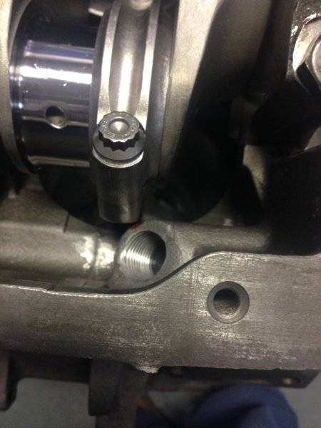

I went with the ultralight crank to see if it would help with clearance. Should all fit without clearancing 512ci
Crank isnt the issue with clearance and won’t make a difference. The 4.250 kit falls in pretty good with the chevy pin. I only had to clearance the oil pump boss a small amount. Cylinders didn’t need anything.

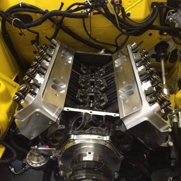

I built two 400 block 451/452 cut down 440 steel crank motors for drag racing (550 HP). One low deck stock rod 6.38), one stock 440 LY rod, both shot peened, SPS bolts. Short rod version ran 7200-7400 rpm through traps. Took it apart still running fine but #5 main cracked in half & crank didn't ring like good steel crank does. approx 400 runs. Block (3698630) held up fine, no more heat than similar 440. Rod angle depends on L/R ratio (rod length/stroke) which affects wall loading, ring life and wear difference is minimal. IMHO L/R does impact intake & head performance. Shorter rod makes bigger port heads/intake more responsive. Keep RPM's below 6500 & have no durability issues. Modern crank & rod combos should be FAR more durable than the stock based stuff I ran. Longer stroke, more cubes, more torque. FYI my 500" RB, EDE head, 10.5 CR motor was very streetable & brutal on the tires.

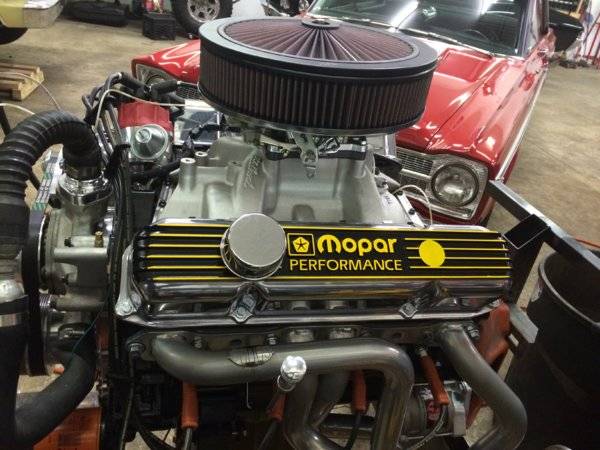

Low deck 500Ci scat crank wiesco pistons and k1 rods. trick flow 270 heads, bullet solid roller. best to date 11.32@120mph. in my 3900lb coronet.
