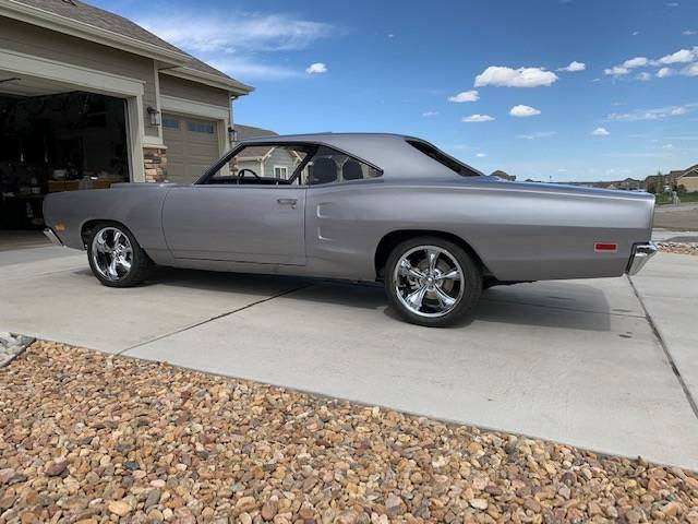

17 x 8 front
18 x 9.5 rear
18 x 9.5 rear
What rims and sizes?
Any tubbing or all stock?
Thank you. Looks sweetThese are 18x8 in the front and 8x10 in the rear. No tubbing but I relocated the springs. I really think that I could go 315 as it sits now with the right back spacing. I really wanna do the US Tool minitubs and go 325 in the rear.

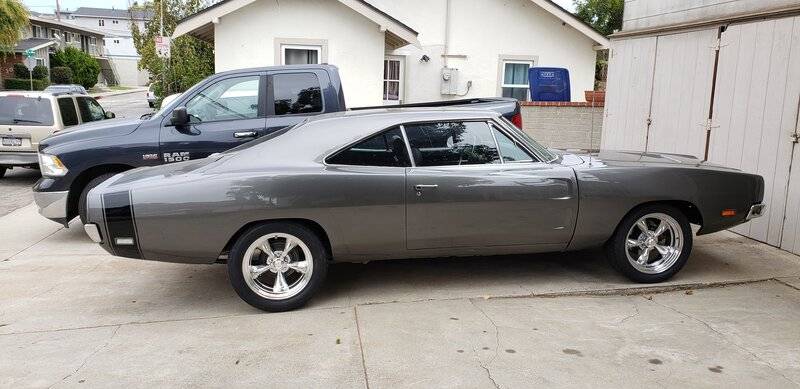

Thats a nice ride too. What smoked glass are you usingMy 69 in the build state, 18" Riddlers , 8 1/2 rims X 235's in front and 10 1/2" rims X 275's on the rear.... plenty of room. Adjusting the height with .103 torsion bars up front. hoping to get the stripe on soon to make it look like a real car! Actually had a guy follow me home from a neighborhood cruise and ask me what the car was? Lol Getting the smoked grey windows in a little at a time, and still have door windows, rear glass and wing windows for sale if anyone needs some glass?..OEM green tint in great shape! I just HOPE mine looks near as good as the gorgeous cars that the other members are putting on here. Great stuff FBBO members!

No, but I am SURE that I can pull it off. 305s now with enough space but it will be snug. Springs have been relocated.Anyone ever run a 315 in rear without tubs?
I call bullshit. The rear wheels look a LOT bigger than an 8 inch diameter.These are 18x8 in the front and 8x10 in the rear.

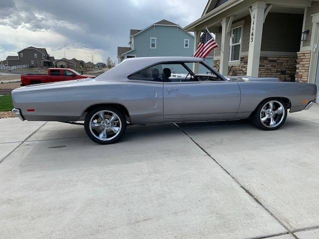

New update... new shoes new rims. Now time to set the ride height.
American Racing VN515 polished Torq Thrust 2 1 piece
18x8 4.5bs - 18x10 5.74bs
Nitto nt555g2
255/45ZR18 - 295/45ZR18
Yes. 440 torsion bars. 440 leaf springs all new but in stock formNice. Stock suspension?
