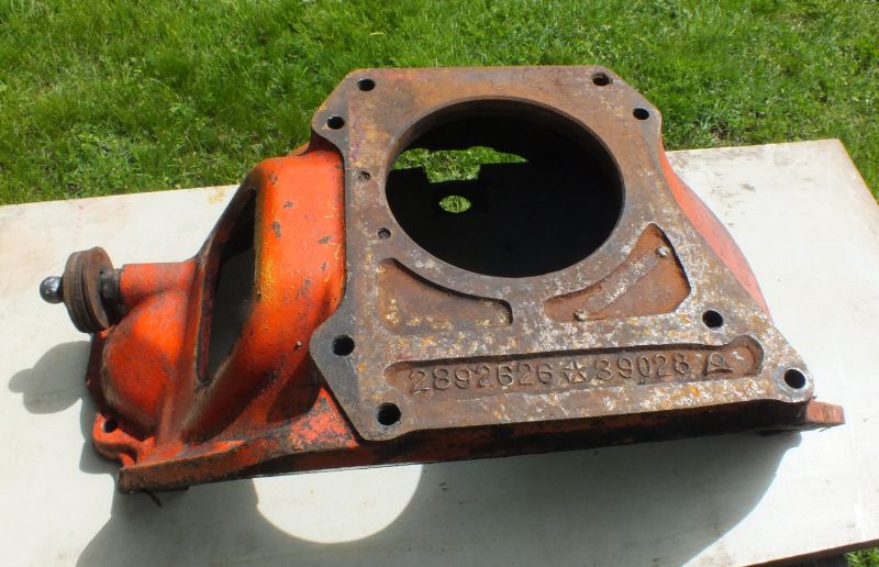

I bought a 4 speed trans/bell housing from a big block 69 Road Runner , I then bought a 11 inch clutch kit . My son and I went to bolt the bell housing to my 440 and that's when I realized that the pressure plate is hitting the bell housing. Do they make different pressure plates for the 11 inch clutch or do I need to get a different clutch kit?
Trying to word this without sounding like a dick. You are sure you have the 11" and not the 10.5" right?
Do you have the number from the bell housing?
Only bell I ever had work on a 11" was a Hemi or Blow proof. Most factory bells I have seen are 10.5"

My first thought is- you have a 10 1/2" bell house. Don't know about 383, but 440 had 10 1/2" and 11". Your casting number will tell which one you have..............................MO
Here's a picture of my 1969 bell that used an 11" flywheel. Does this match your number?
Photon440 thank you for the picture . I checked the numbers on my bell housing and it turns out that I have a 10.5 bell so I guess Ill just go and get a different clutch kit
I did some checking and what I thought was a 11 bell turned out to be a 10.5 so Ill just trade my clutch kit in for a 10.5
