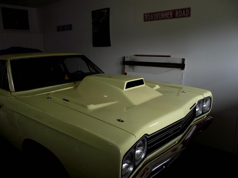

This is what a stock hood looks like with a scoop ... meh !!

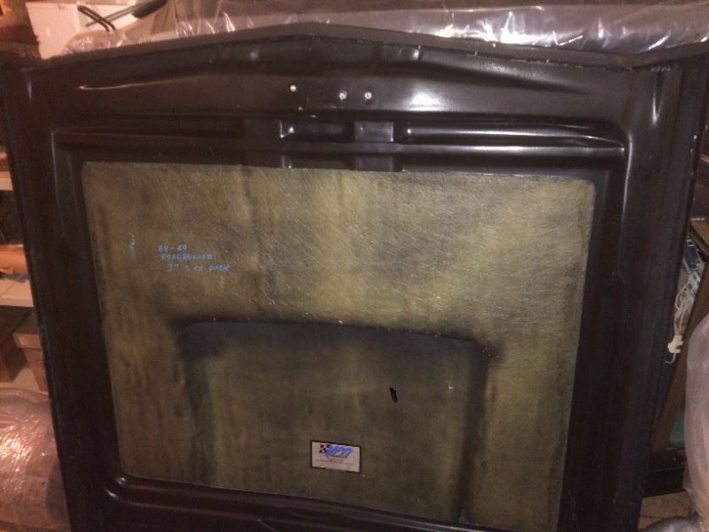

Next is the bottom of my "6-pack" hood - might give you an idea. FWIW, it clears a single plane Indy intake on a RB with air cleaner. Would likely clear two carbs on a crossram. I have about 3/4" clearance on the top of the air cleaner using a drop base.
Most of the aftermarket 6pak hoods don't have as much underhood reinforcement as a real one.(more clearance)
Gkent's vfn looks like just what you need.
Edit: notice there is a relief for his Aircleaner in the rear brace.
