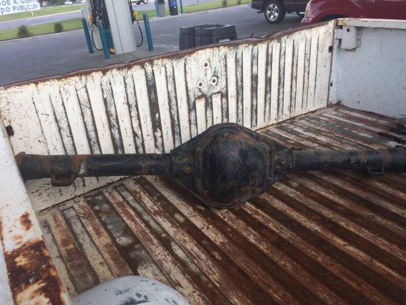

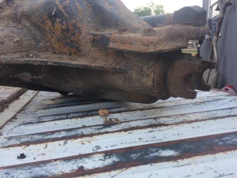

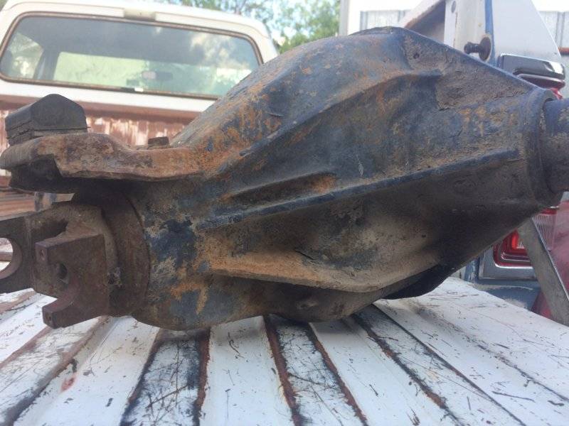

Just picked up this Dana 60 from a friend selling his statch of Mopar stuff, he’s telling me that it’s a B-body Dana, “ how can I tell “ !? It’s going on my 69 Charger ... along with a 68-426 Hemi I’m trying to convince him in selling me .. I don’t see any cutting or welding besides da factory work !? Nd r da axles r like da 8 3/4 that bolt at da brake/backing plates !? ...
31D20967-B348-4F7D-8685-1E2CF9DFE282.jpeg E975100B-FCD1-4BEE-8500-A638058A28DB.jpeg 12193770-CD5A-43E2-A734-5E65565739B8.jpeg
Measurements? It has a pinion snuber so its a car application.
There are numbers on back of right axle tube. Looks like a 7290 yoke so probably a 68 or newer rear.
Fran Blacker ... Great info on there ... Nd yes cudajunction snuber looks like original one, I’m cleaning it tomorrow to take a look at those numbers, Nd he did say it had high gears on there ..
Thanks guys ... it does appear to be a real B-body Dana .. still I haven’t had the chance to clean it And run da numbers on it .. thanks ...
