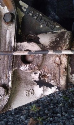

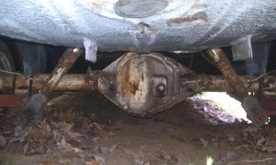

Any way to tell if this came from a B-Body?
Measure the width! I doubt its a trk. but if it is it won't have a place for snubber! Casting number will tell you what it is for sure!
The BOM number should be on the right axle tube on the back side....may have to clean it with some medium grit sang paper to see them. You can then look up the numbers on the net and they will tell you everything about it.
as you look at my pic, on the right side of center where tube comes in I have a C34155 and a # 80 on the bottom right?????
And that looks like a 60 to me.....a cast in 6 looks really close to an 8 and the C3XXXXX numbers isn't the BOM number.
Axle won't have a mopar casting number, as the Dana is made by Spicer. It does have a stamping on the tube if I remember correctly. It might have had a paper tag with the part number on it also when new. As far as the width and all, the B-body Dana was:
Housing Width (flange-to-flange) 54.94"
Spring Seat Width (center-to-center) 44"
The spring seats would be the easiest to measure unless you took off the wheels and drums.
