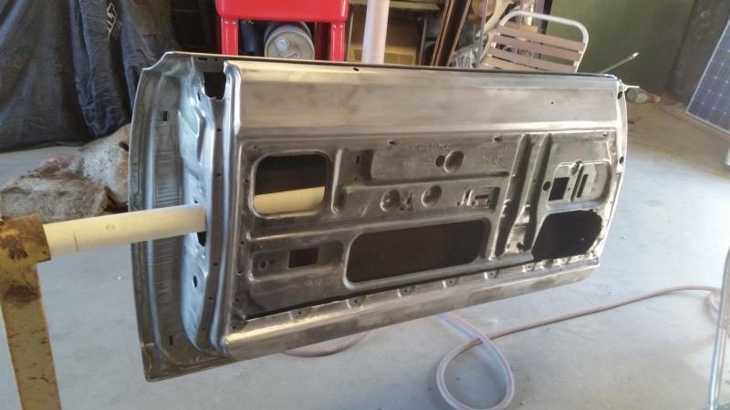

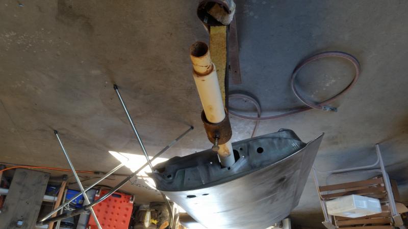

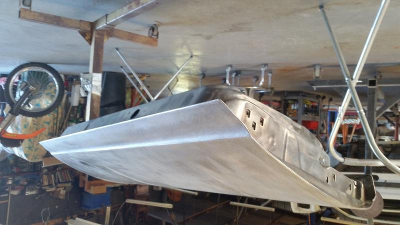

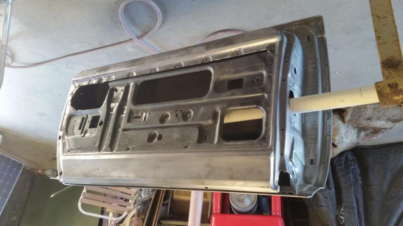

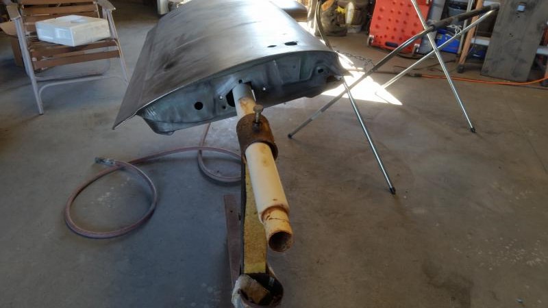

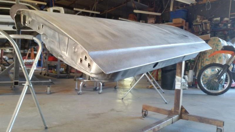

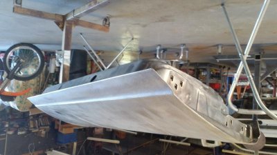

I have discovered a new use for an engine stand. It makes a handy door paint jig, which saves time and materials by allowing the entire door to be painted by rotating it without touching the door. All this takes is a pipe thru the center section of the stand then thru the striker hole in the door and attached to the far end of the door (attached with a u bolt for support. See pictures below.
Cool but I hurt my neck trying to look at it lol
Cranky
It wasn't easy standing on my head to get these pictures............ha ha
