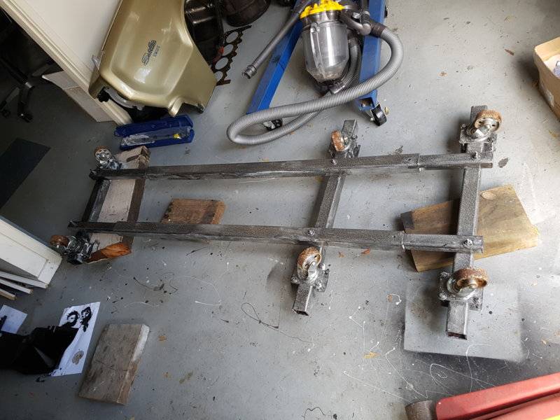

I made mine, was a project in itself! probably spent $200 on the materials.

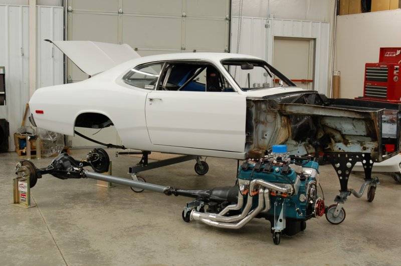

Here’s what I built. Flat plate that bolts to the bumper bracket mounting holes. Weld the plate to square tube welded to Harbour Freight caster wheels.

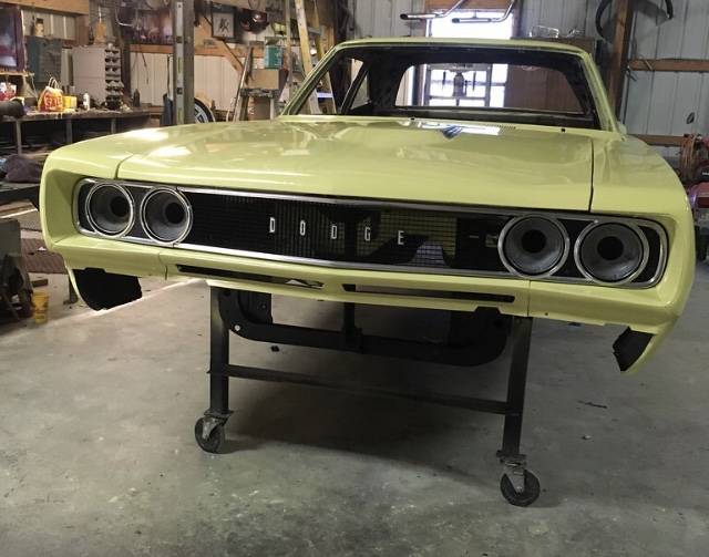

I did the same with scrap metal I had laying around, but I went with 7 or 8 inch wheels. Figured it would move around easier than with small ones.
If you're building it to roll the engine/trans/k-member around, just keep in mind that it has to be low enough to roll under the car for assembly - you don't want HUGE casters on it. Just how often do you plan to move the thing anyway ?!?!
Yeah bigger wheels are the way to go. I wish I had went with ones with tires so I could at least roll it outside some. These keep you confined indoors for sure haha.

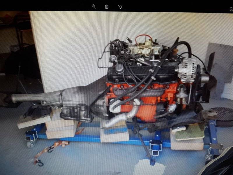

The OP is referring to a cart to mobilize his K member/engine/trans as a whole unit. Not the rolling shell.

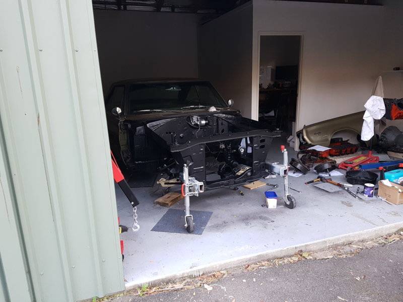

I read it wrong too...for moving the body around I just bolted 2 steel beams to the front bumper mounts and attached trailer jockey wheels. It was easy and I could raise it up and down.

I make carts for everything. Body, engine, trans, K frame, rear end, etc. I'm always taking stuff apart and moving it around and putting it back together so having some carts on hand makes it easy.
