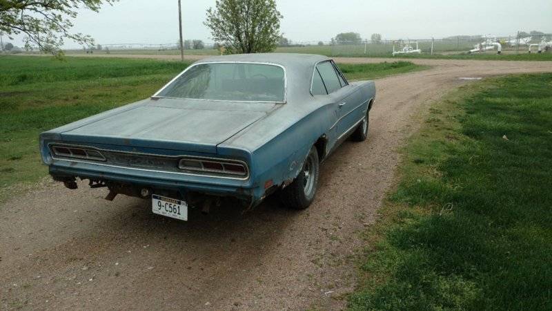

68-70 rusts in the rear windshield lower corners, trunk floor, behind the rear wheels, in front of the rear wheels, and the whole rear wheel arch area. Usually in that order.
More severe but less likely are rear frame horns behind axle, and front horns around the UCA mount area and torsion bar cross member area.
...also floorboards around the T bar cross member area.

This car is a good case study in where 68-70 rust issues appear.
It has nearly all of what I described above.
Check these areas thoroughly with your eyes, fingernails, and a magnet.
Too bad about the listing as it is a factory 383 four speed car in a cool color.
