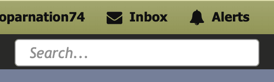

There are many informative threads here on this process and you can utilize the search tool above to find them. Also, READ the service manual......
As far as jack stands go.....The car can stay on them indefinitely...In regards to placement. That just depends on the stands you have. I place two large ones in front of the K frame by the rad support and two smaller ones beneath the front floor pans on the frame. Lastly, I take my floor jack with a 12" 2 x 6 with a rag on top underneath the oil pan....Excessive, maybe but I put safety first before anything else....Especially, when your banging on stuff...As you will be to get the torsion bars removed, balls joints loose etc...Also, you have to release tension on the LBJ by jacking the drum....
Its more to it than just pooping loose a ball joint.....Once you get the process it is time consuming but not bad to accomplish...
I just do not understand why people just cant utilize the resources already here? You learn more when you research things more......

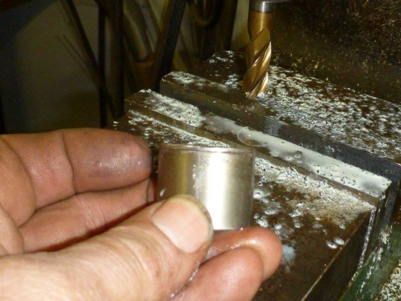

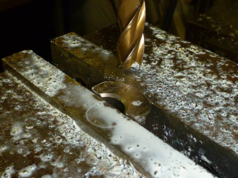

Jim Lusk has a great tutorial for LCA bushing replacement:
Here are some tips from my experience:
FEF part 1,2,3
Never heard of using a tap, pretty cool. My past searches here and other places never brought that one up. I tried to weld the washer on the old sleeve but it would just rip the metal apart, never worked for me.
