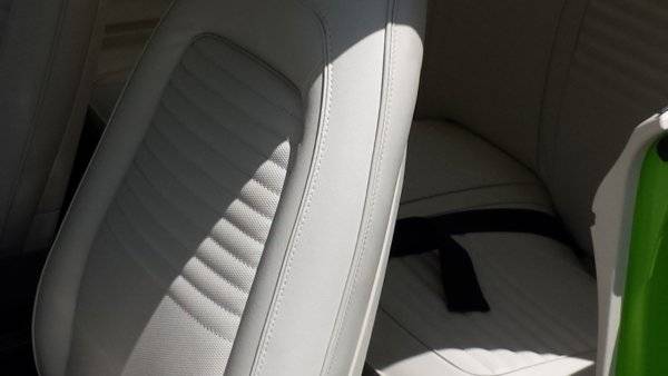

I haven't done a B body but did a 3" tub on a 70 Cuda. Had to cut, trim, reshape the outer sides of both the top and bottom frames. Then had to modify the covers to fit. Can't believe I don't have better pics. It came out real good and can't tell its been tubbed.
Now have to do the same for my Dart that been mini-tubbed also.
