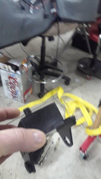

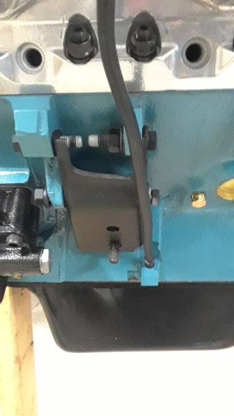

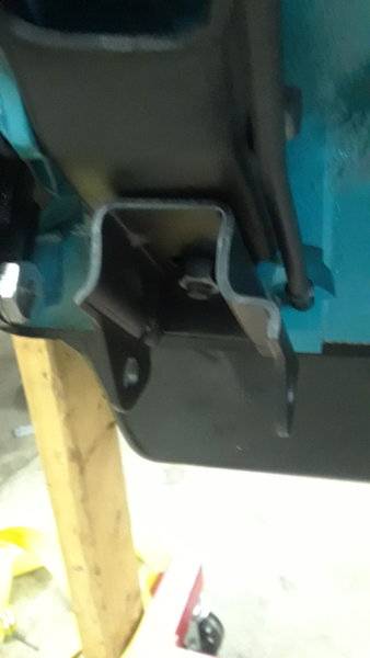

I currently am getting ready to install a 440 in my 68 charger. with the stage 6 heads, and the spacers required for the intake I'm pushing my hood clearance. my mounts to the isolaters have two holes, which i robbed from my original motor in my car when it had a scoop on it. My question is, can i bolt the isolators to the upper holes in the mount to lowers my engine or will it change the distance for bolting up to the K-member. currently in the lower ones in pic, bolt was welded in by previous owner.thanks!

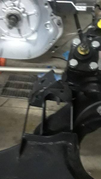

I guess it depends on the difference of those 2 holes... I would think not cause the oil pan will end up resting on the center link and if using headers they will be laying on the steering box along with many other alignment issues...

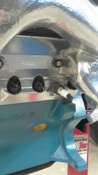

Looking at your heads they appear to be the angle plug version. I think they made straight plug too... Anyway you may want to see if your exhaust manifolds and those angled plugs with wires will even fit with stock exhaust manifolds....

Won’t work. The motor mount bolt hole spacing will be off, in addition to trying to wedge it down further between 2 fixed points.
And the stud is on the other part of the mount and protrudes through the bracket with a nut on the other side. The second hole is for the alignment nub that sticks out on the other part of the mount. In its current setup you are going to run into issues trying to install the engine. Assuming it’s a stock k member.
