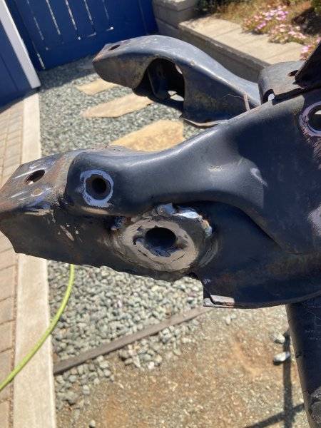

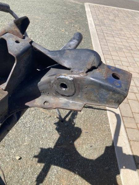

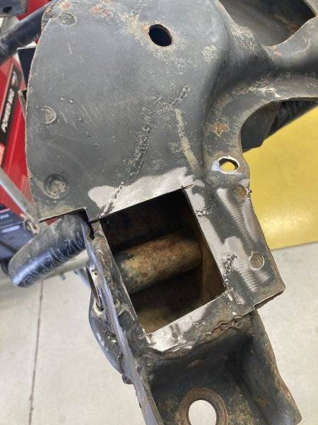

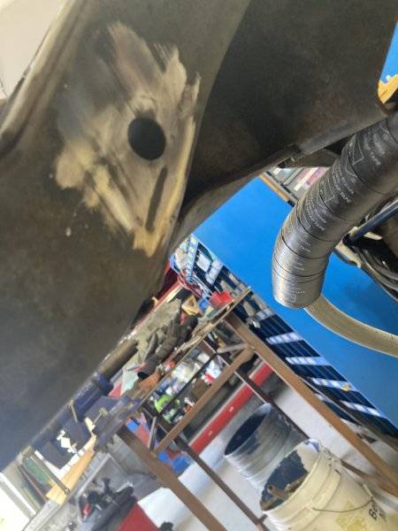

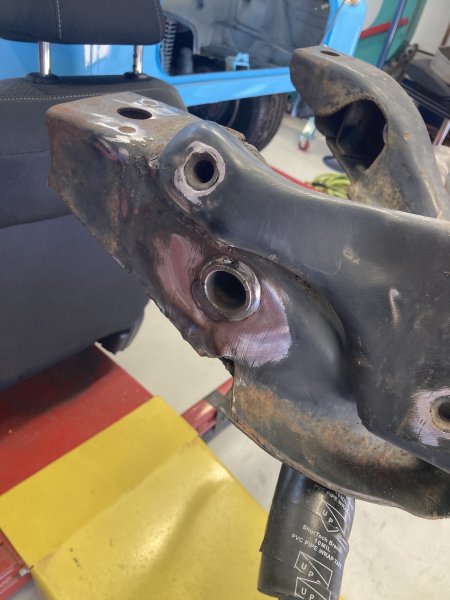

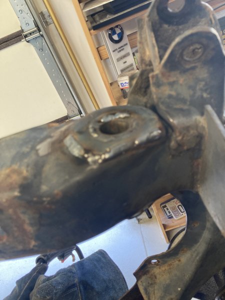

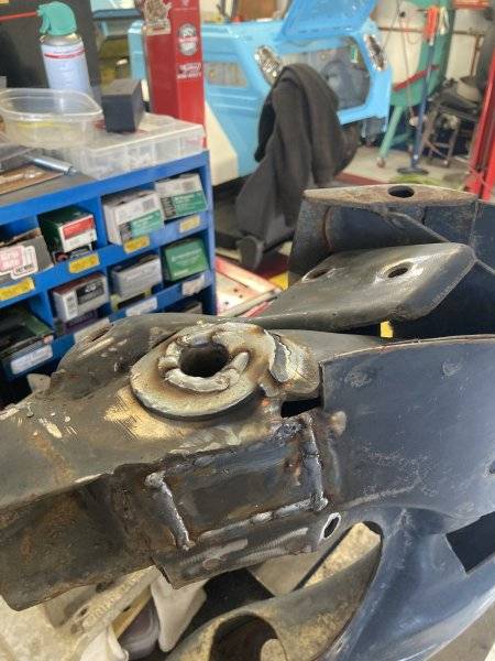

I scored a 70 k-frame at the Spring Fling earlier this month. Bought some washers for the control arm sleeves in the k. Cut windows in it to get some weld on the back sides, especially the nut end. With the exception of not having my skid plate yet, welding on the k plus mods was maybe 2 hours of work.
