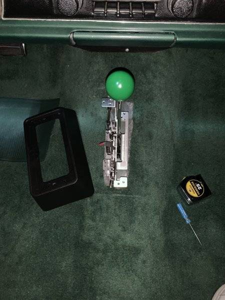

I've installed this shifter in my 75 Scamp over the past couple days. I still need to trim the front and rear portions of the cheapo plastic tower. I have a "contour gauge" on the way. Have you installed a similar shifter? How did you go about trimming the tower? Any tips you can offer? I'm aiming for a really clean look.
Thanks!
Since we all like pics...
I've used a both flapper wheels and carbide cutters. It's really not difficult just go easy...if you take a little too much it won't smush into the carpet and have a gap.
I draw a pencil line that matches the curve and start by leaving it a little long, then fine-tune it as needed to get it to fit. The one I have now I painted with the same (Herb's) interior paint I used on other pieces.

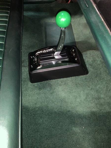

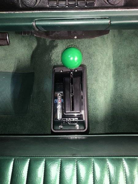

Well fellas, if anybody gives a ****, or for future searches... I used a "contour gauge" to accurately get the shape. I used a 3" air cut off tool got me in the ballpark, then a small rasp on a die grinder to get closer, then sandpaper to smooth out and finish.
Hell of a job, many might not use ratchet, I like where you went with it, shifter & green ball is pretty rad!
