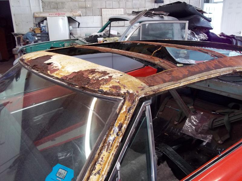

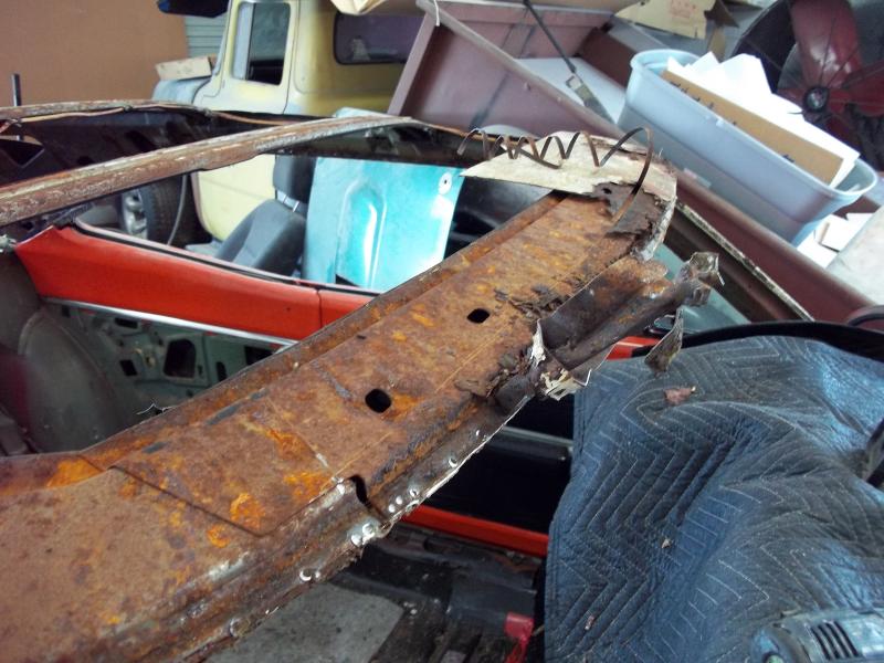

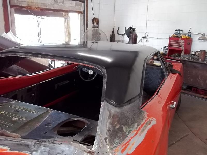

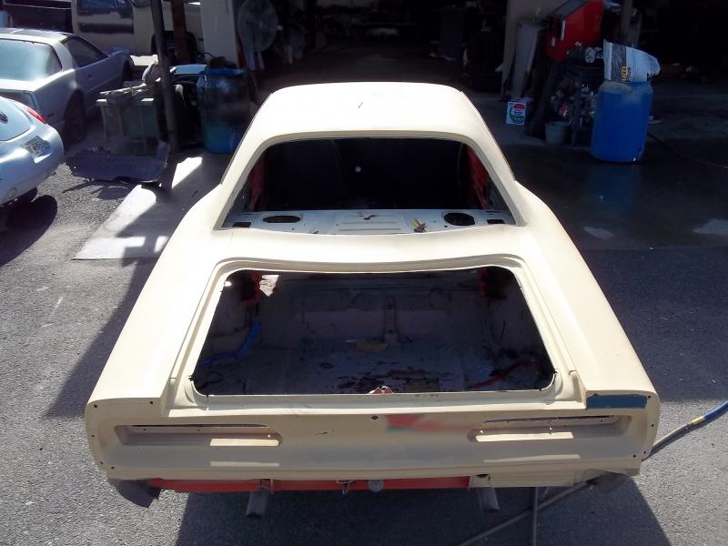

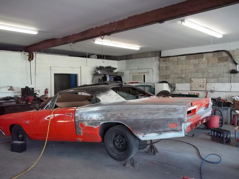

I began the restoration of my 69 Bee in Aug of 11. Starting by replacing the roof panel.

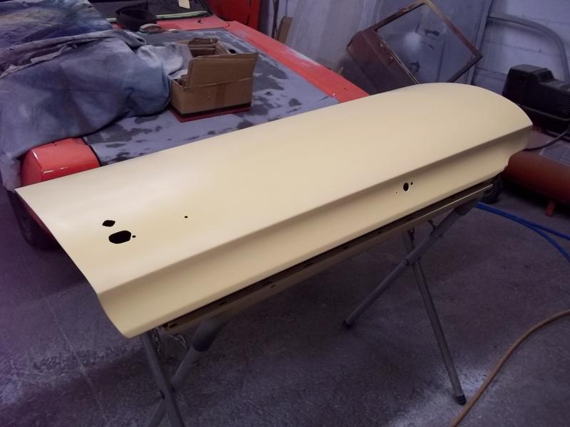

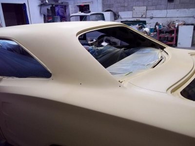

memorial weekend in Ga 019.jpgmemorial weekend in Ga 029.jpgbeeinpaint 002.jpgbeeinpaint 024.jpgAfter the roof skin was secured the panels were chemically stripped and then media blasted before being repaired.

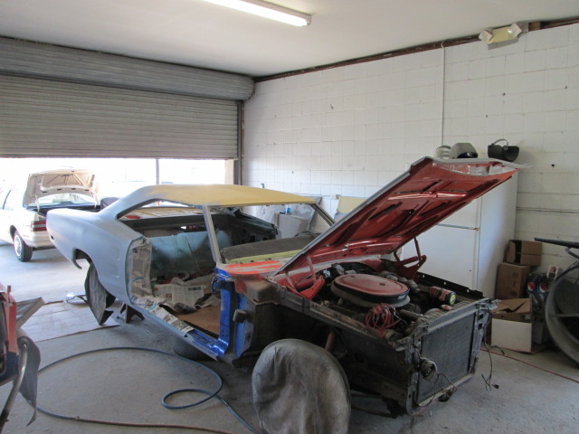

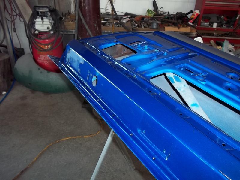

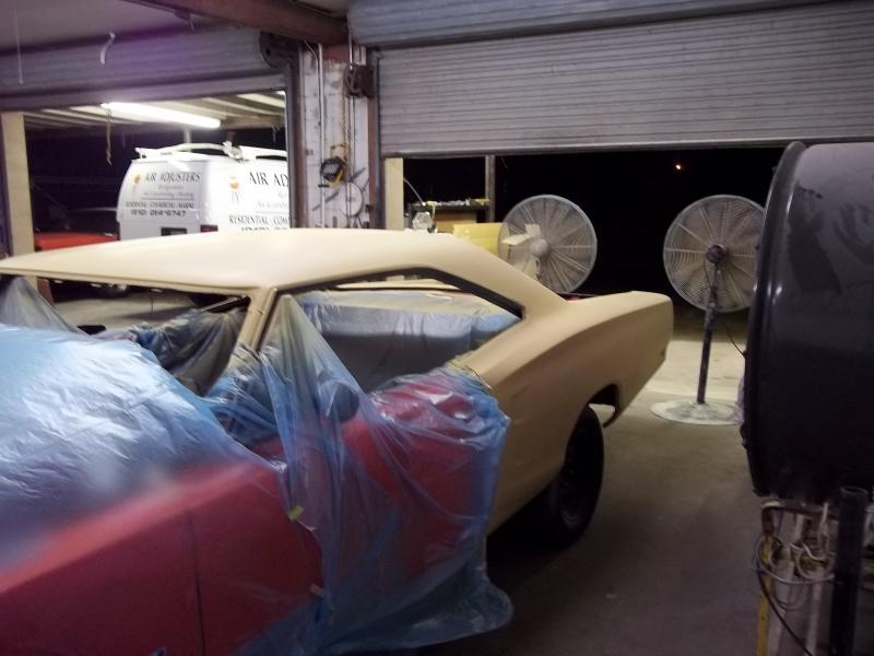

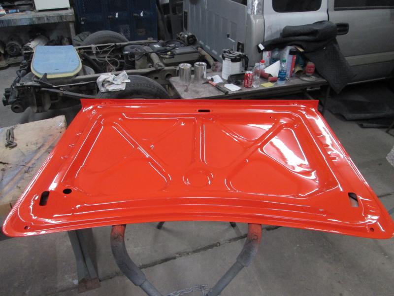

I've been working 14 hour days for the last 12 days in a row trying to get her (The Bee not the Wife)in paint. I have changed my mind about the color again and will put her back to Hemi Orange. Hopefully I'll be able to at least have her painted before i have to go back to work next Monday. Here's what I've done so far....4th of july in Ga 2014 6_25 026.jpg4th of july in Ga 2014 6_25 027.jpg4th of july in Ga 2014 6_25 033.jpg4th of july in Ga 2014 6_25 034.jpg4th of july in Ga 2014 7_2 039.jpg

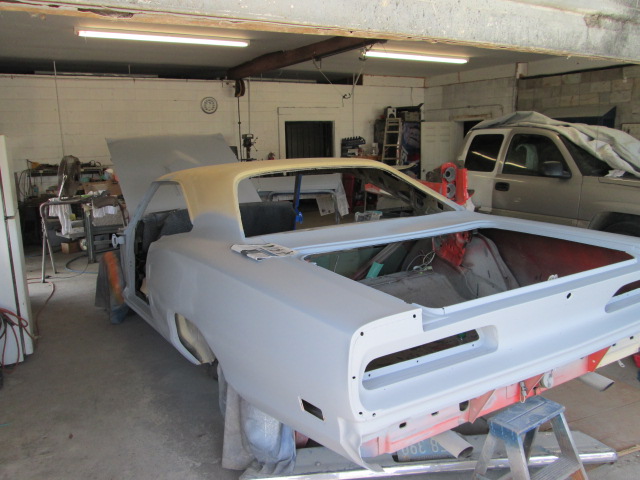

Not enough time for all over paint.

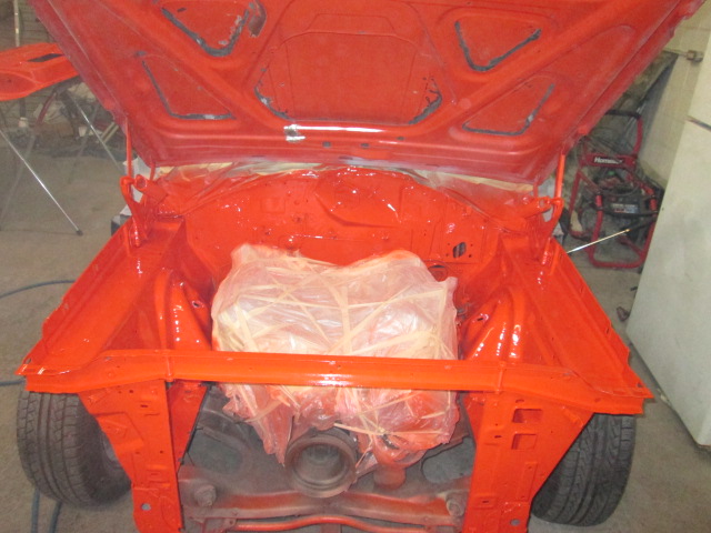

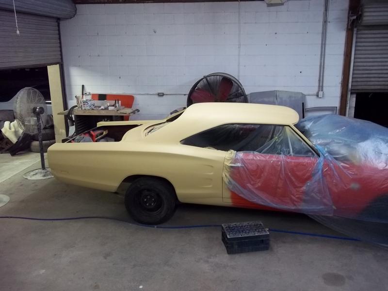

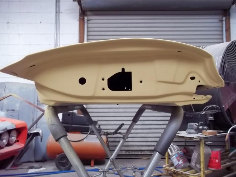

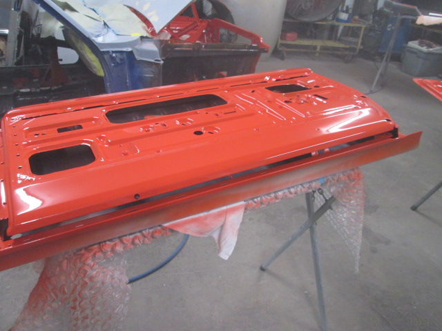

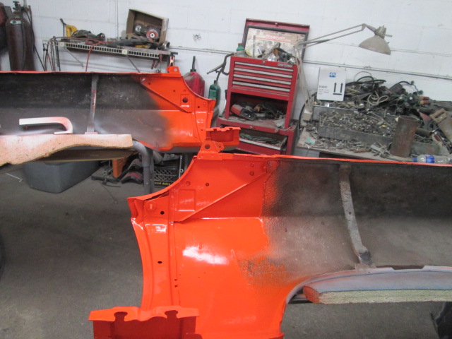

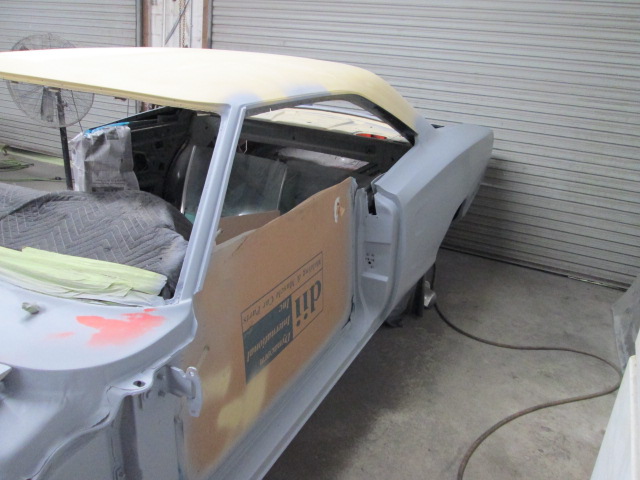

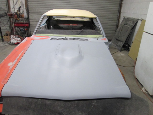

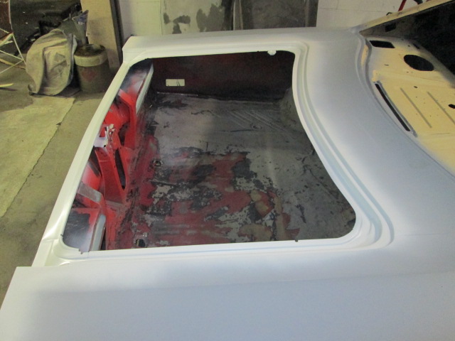

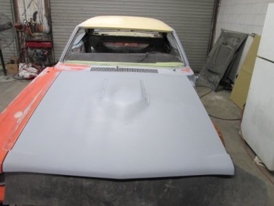

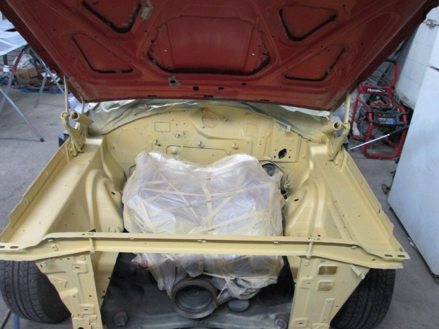

Since I have to be back at work on the 7th (this Monday) there wasn't enough time left to get the Bee in paint this trip. All of the body work is completed with the exception of a few dings on the power bulge part of the hood.

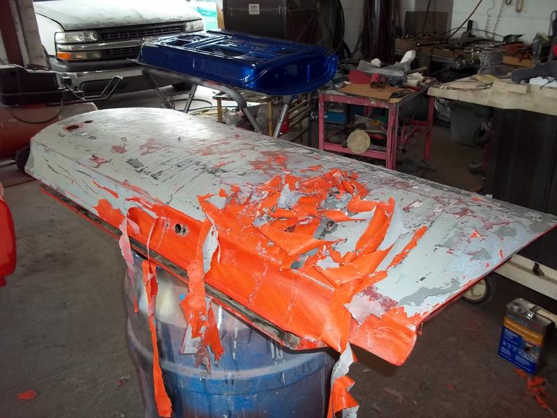

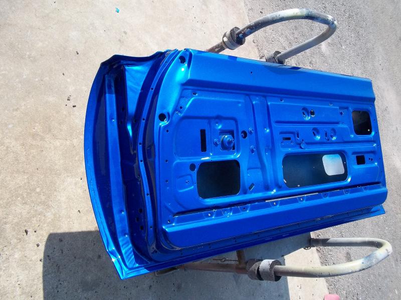

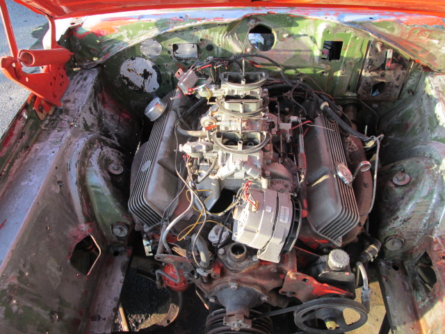

Everything is cut in paint wise. the insides of both doors are done. The cowl on both sides along with the inside of the fenders. The fenders were treated with POR15, self etching primer than epoxy primer before sealing. Followed by color and clear. The inside of the engine compartment was such a mess that I ended up chemically stripping all of the layers of paint then pressure washing the whole car prior to sealing prior to paint. I didn't plan on spending over 40+ hours on the engine compartment but the results were well worth it.

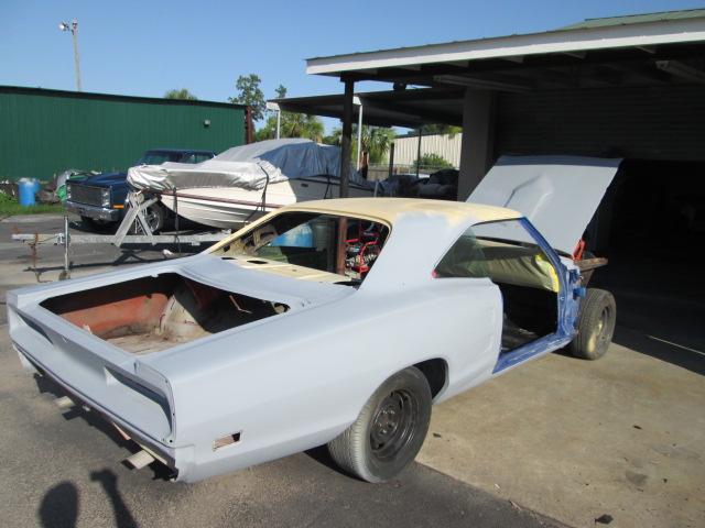

4th of july in Ga 2014 7_2 051.jpg4th of july in Ga 2014 7_2 039.jpg4th of july in Ga 2014 7_4 019.jpg4th of july in Ga 2014 7_4 039.jpg4th of july in Ga 2014 7_4 040.jpg
Sure am glad that I went back to the Hemi Orange:hello2: It just fits..4th of july in Ga 2014 7_4 035.jpg4th of july in Ga 2014 7_4 042.jpg
Hopefully I'll have a couple 3 day weekends off from work to try and get the Bee totally in Orange.

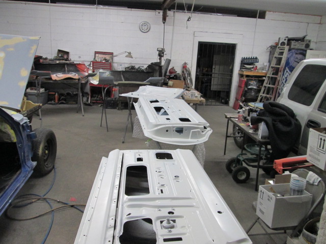

The Paint is a 3 coat system. White sealer. color base than clear coat urethane.

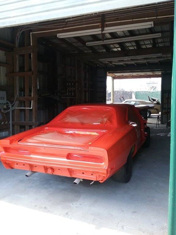

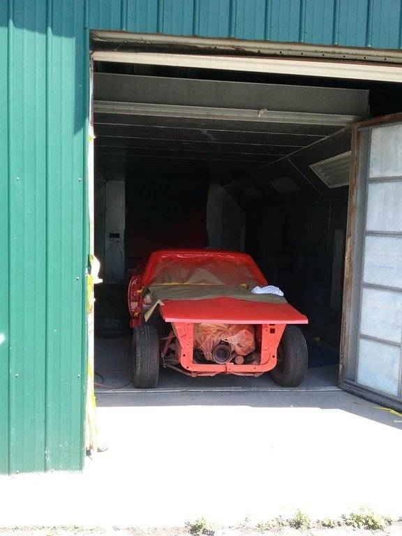

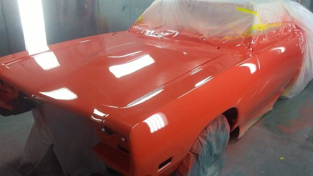

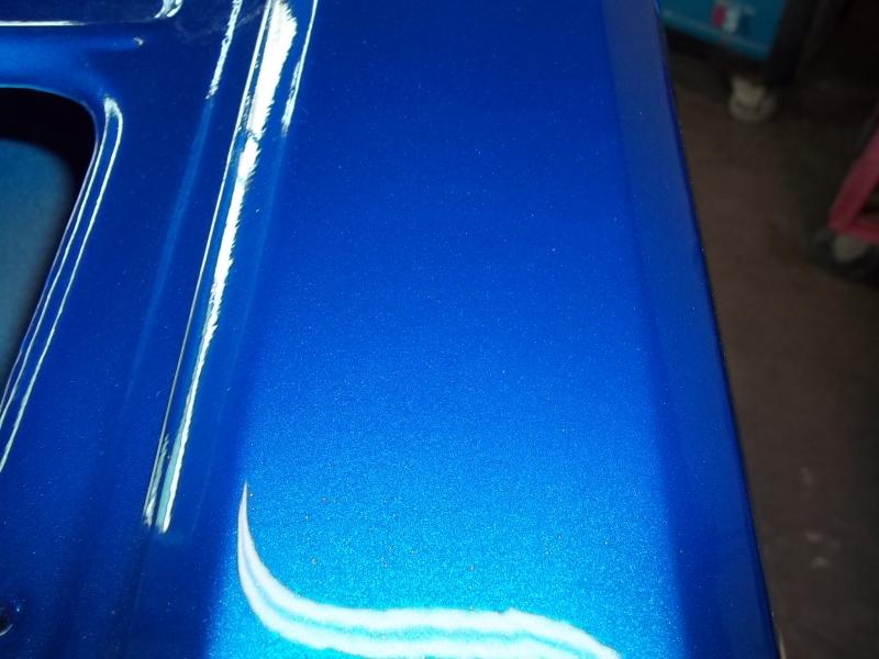

Since my last post, that famous, " Life happens" quote. Has happened more times than what previously was believed possible. I have endured multiple major surgeries. My wife, God rest her soul passed away in my arms one year ago this week. My last surgery was on the 20th of June this year. And I was able to get the second application of the final clear coat on "Half of the car" 12 hours before surgery.
sorry for your loss. sounds like life gave you a good kick in the gut, but you picked yourself up and are moving on. The car looks great.
Fast forward to last weekend. The Bee is finally totally painted and my brothers paintbooth is no longer being held hostage.
