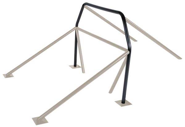

To retain the rear seat, the download bars to the rear off the main hoop are longer, run along the top of the rear side windows, and then drop down thru the package tray into the trunk.
Because of the extra length and the bend, it isn't as strong or safe as a straight rear bar that goes thru the seat back area.
The rear down bars have to be specially formed to go over a rear seat.
My roll bar rear bars are above the back seat, go through the package tray to the rear shackle area. The back seat is a PITA to install or remove, but can be done.

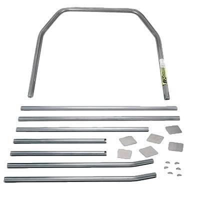

Competition Engineering
(says 68-74 B-body, I assume it can fit early & later years too)
makes an 8 pt rollbar/cage kit
with minor mods/bends make it follow the roof some
I moved them a bit more towards the top of the rollbars
top curve/bends too
went straight-ish/level-ish with a slight downward angle 5* (?)
from the rollbar, for like 18"s, then bend/bent down
to go thru the package tray near the rear of it
they could be made to work

click on photo has part #s

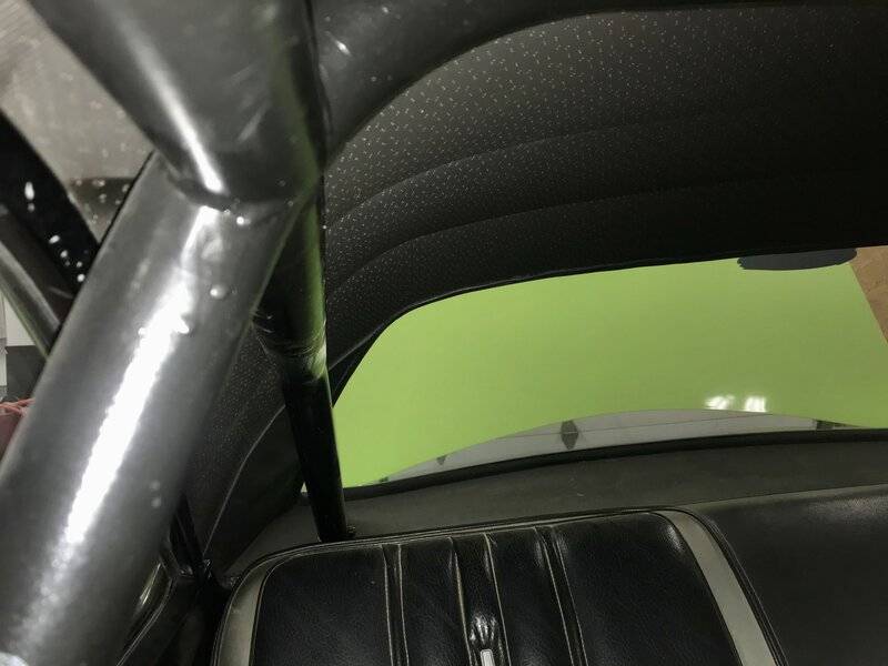

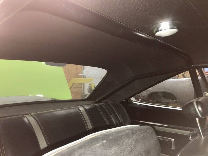

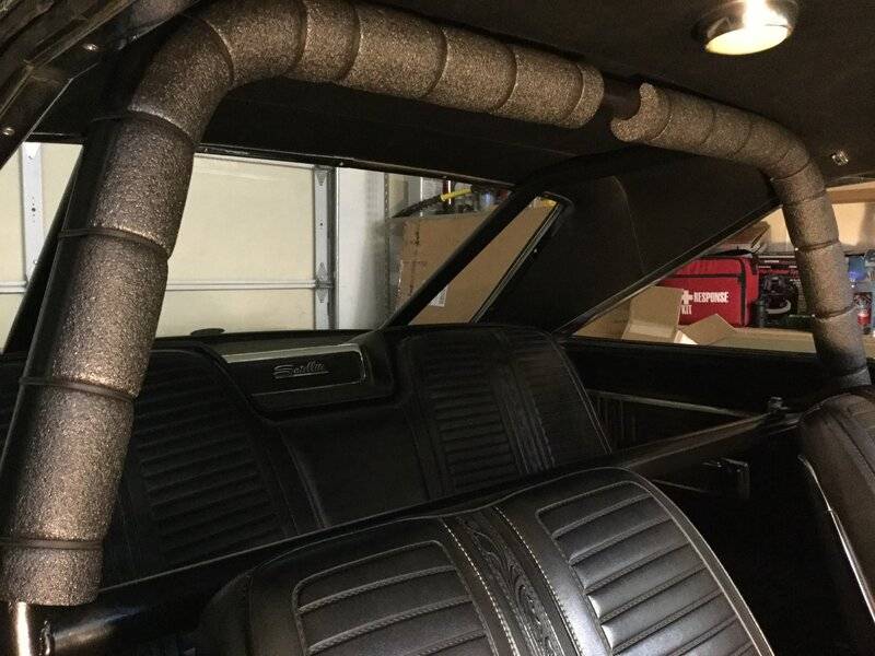

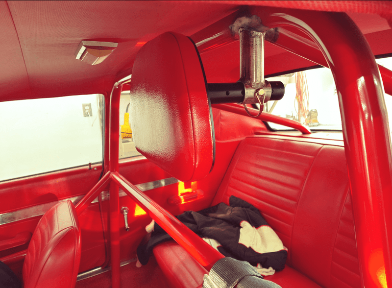

Mine isn’t a kit, and is in a 70RR but might give you some ideas. It’s chromoly and an 8.50 cert cage but the same principles apply. If you can find someone to TIG weld, chromoly will save you a lot of weight. The entire 8.50 cert cage with swing out door bars wasn’t much heavier than the mild steel DOM 6pt roll bar I cut out.
3237A9E6-56EF-4557-9C95-69995F809309.jpeg 89367EAE-77B0-4980-91FD-868D24B8D942.jpeg 58420598-0641-40F6-9CC6-2EB17BA93BBB.jpeg 5F5A0060-106B-40C3-8F77-DC1BAB175195.jpeg
Not a lot to see at this point, it's still pretty early in the process. I'm building the car to go do dragweek and may or may not run fast enough to need an 8 point bar to be legal, but I'd like to have it in any case for safety.
As others have said, the rear bars just need to go through the package tray. I had mine custom bent to follow the roof & glass line. The tough part is getting the seat back in around the main hoop. It is a major PIA. I then did a minitub, which was really tough because I couldn’t get the seat out past the main hoop. And I didn’t add the kicker bars; with those, forget it.
in the end, I’m glad I did it this way because I like the full interior look, but I certainly understand those that said screw the rear seat.

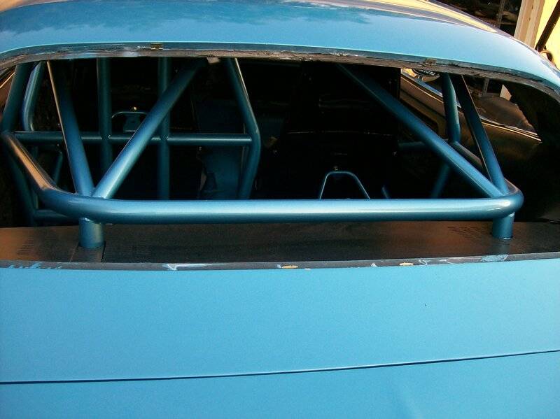

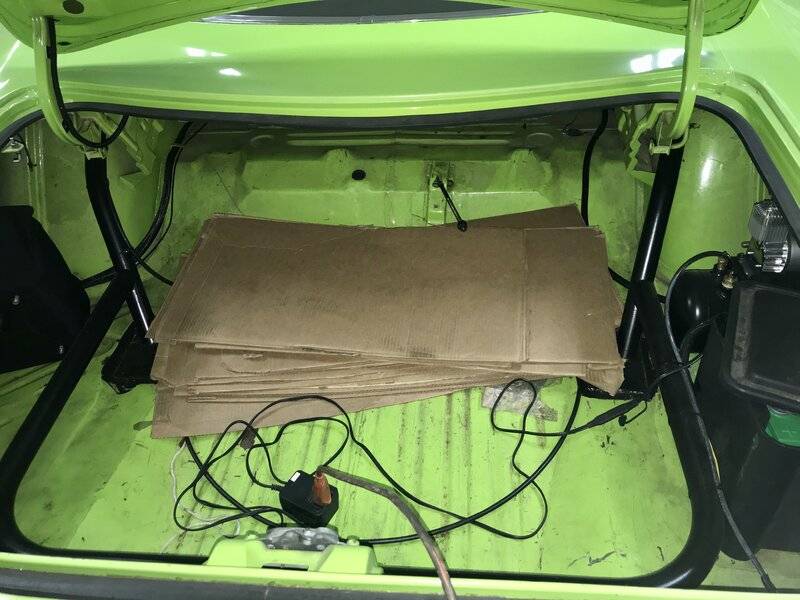

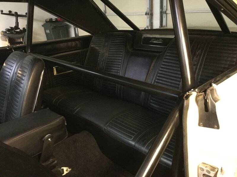

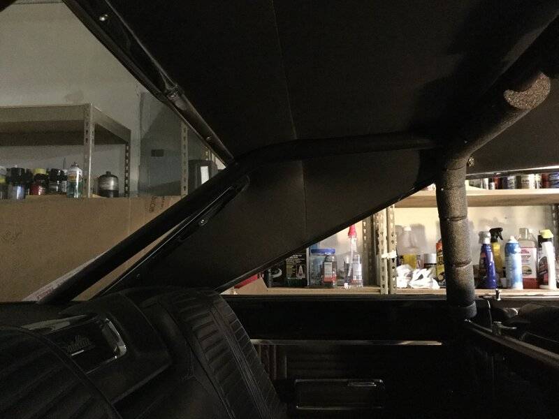

Consider having a chassis shop build one for you. My local race shop custom tailored one to my car including keeping arm rests on the doors and keeping the back seat as well as little touches like matching the B piller angle. Very happy with what they came up with!
As Hemirunner said. Mine isn't a kit either. We custom made every bar. Mine is all chromoly and 25.5 (7.50 cert) with full interior with back seat. I have 2 down bars that go from the main thru my rear seat bottom down to my front leaf spring perch pockets. First 2 is showing the rear seat. The rest are just giving other ideas to do rear speaker tray bars.

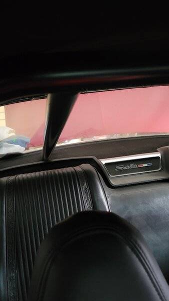

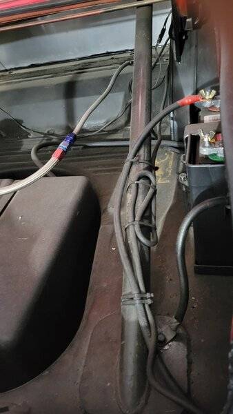

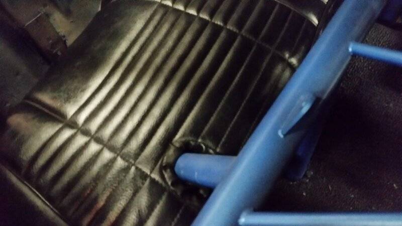

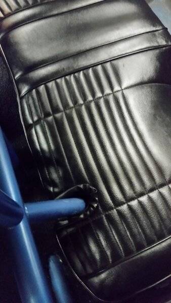

A couple of pics of my roll bar in my '66 Satellite.
