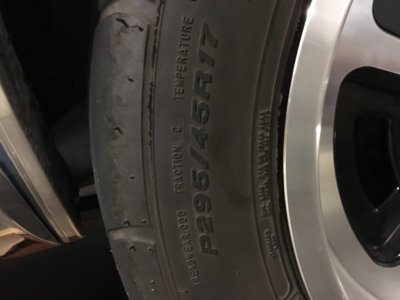

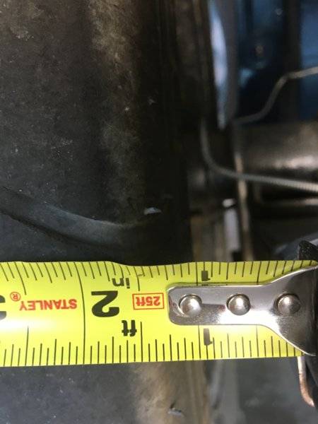

Stock 67 Charger, no tubbing:
5 1/8 BS, 17”x9” rears. Year One magnum 500.
Fits a 295/45r17 no problem. About an inch to the springs.
Chargers for that year are tight!
