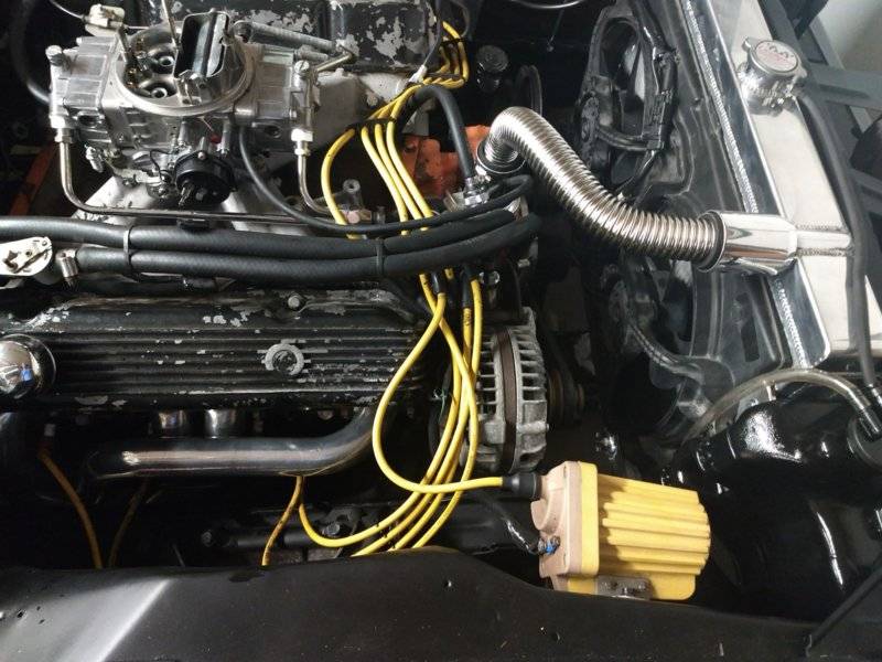

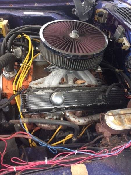

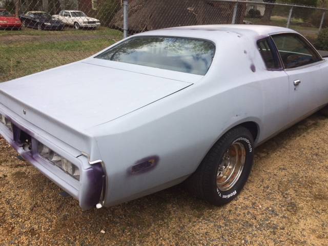

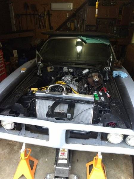

You have alot of info here to go from but till then I think we all would like to see some pictures I know I would !
Its hard to get any good pictures in my garage but here are a couple from when I got it, the engine bay before the clean up and what it looks like now.
