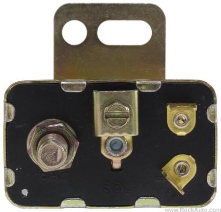

Here's a pic. The 4 connections are from left to right: battery+, starter, top right is NSS center pin, bottom right is yellow from ignition switch (starter circuit). Doesnt matter which way you hook up the NSS plug at the tranny, as the outer 2 pins are the same and just make contact with each other or dont.

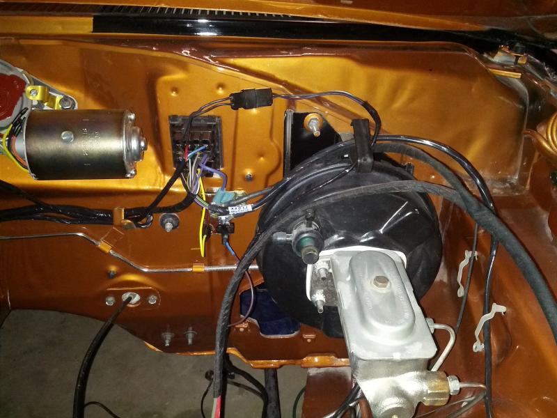

See the black connector at the top of this pic with the purple and black wire, that is the backup light wiring and connector. The brown wire connected to the starter relay is the neutral safety wire. How it's actually supposed to route in the car I'm not sure. I've routed it differently than what's in this pic but I thought this would give you an idea of where it connects.

So does it have to plug onto both switches on right side of terminal? Does it have to be grounded also? (Have a single wire with a connector on end and not sure which one it hooks 2) Does anyone have a pic of their relay with this plugged onto it? Thanks Nick
Looking at the pic above, it goes to the top right terminal. The other two (outer pins) should plug into the bulkhead.

So i plugged it to top right terminal and started car; worked. Then i put car in neutral w/ foot on brake and started car; car still started.
Does this mean that the relay itself is no good? Neutral safety plug on tranny is brand new and wiring is now brand new. What does connector that plugs onto terminal look like; Any pictures from under someones hood of this connection please? Thanks Nick
That's how it should work. It prevents the car from starting in gear and allows starting in p and n. test it in drive lol
