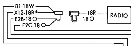

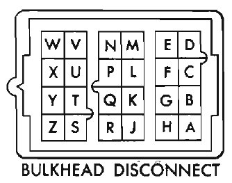

Drawings below are excerpts from this manual The drawings are crops. I don't know why they did not post in order

2---These go to the drawing to the right, "C" and "D" of the connector, which is the engine side of the bulkhead disconnect.
3---To the right of that is shown the engine side view of the entire disconnect for reference
4---In the drawing below this is the INTERIOR view of the bulkhead disconnect. NOTICE "C" and "D" have NOW changed color, you have B1-18W (no 18 white) and B2-18W coming into the interior of the car

6---See the post below. "D" of the bulkhead, B1-18W goes up and junctions at the red wire at the radio connector. This is where you get power to operate the circuit
