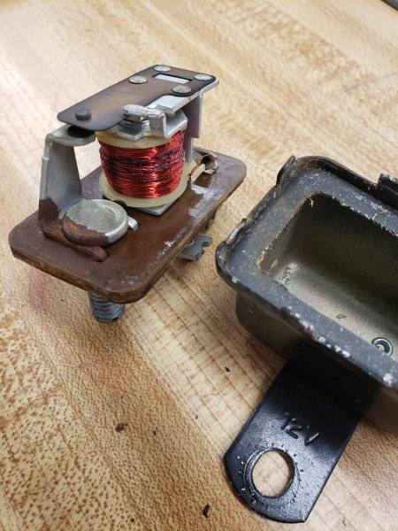

Bad relay. Test light lite every time key is turned on the ignition wire from key switch. Wire from NSS tested ground. Car turned over 100% of time when jumpering - using screw driver between + from battery and starter wire. Replaced relay, turns over every time now.
Just to recap. Before replacing relay, I would turn the key and could here the replay snap every time, but no crank 90% of times tried. About 1 out of 10 times turning the key would provide the starter to crank. Replaced reply and everything is now good.

Thought I would add a photo to show the old relay. After taking it apart and looking at the relay. I could have took the time and sanded the contacts and cleaned up the rust and had something that may or may not have continued to work. $22 for a new one gives me a little more assurance.
