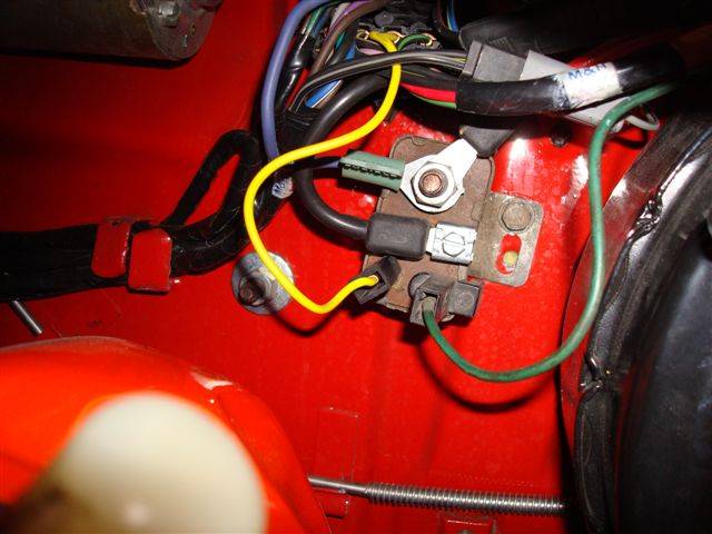

I only have schematics for my 66 Charger. IF your starter relay and wiring is similar to what was used in a 66 Charger, looking at face of starter relay... with the large heavy lug to the left side, that stud is directly from the battery + (Batt). The center terminal (SOL) terminal goes to the solenoid on the starter to supply + 12 volts for the starters internal solenoid. The upper right terminal (GRD), is the ground supplied by the neutral safety switch from the transmission, if there is no ground on this terminal, it will prevent the starter relay from functioning. The lower right terminal (IGN) goes through the bulkhead connector and is the switched + battery voltage from the "start", or crank position of ignition key switch.

The NSS and Clutch switch are just supplying Ground.. Make your self a Jumper wire and Connect it to the NS/Clutch switch terminal of the relay.. If it starts, go back down the line towards the NS/Clutch Switch.. If it does not, jumper between the large lug and the smaller lug on the relay? Does it crank? Yes, Ign switch or Relay. No, Starter or Cables. Want to diagnose why it starts while jumpering the relay? Get a Test Light, Turn the Ign Switch to start, does it light up, failed relay, if not Switch or Bulkhead connector..
Wiring of relay.
Top = Battery
Middle= Starter crank feed
Lower Left (Yellow Wire) = Ign switch crank feed
Lower Right (Greenish Wire) = NS/Clutch Switch
Have fun.
