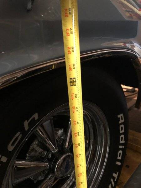

I've been running with air shocks for probably a decade! I decided to put back the correct shocks and the back-end slammed (well almost). The shocks were brand new ten years ago, can they go bad from being uncompressed on the shelf for that long, or did I kill the leaf springs?

Are these original leaf springs? Looking down their length with the weight of the car on them how flat are they?
Yes, original springs and they're pretty flat! I guess using air shocks all this time did them in! So I'm probably not going for new springs before the season is over, any suggestions on what do use to get it to factory level? Thanks.....

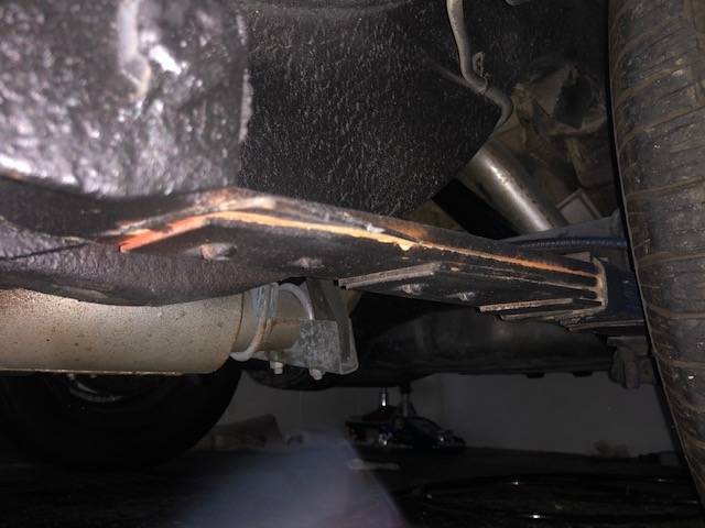

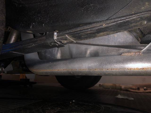

Remember that factory leaf springs sit pretty flat, even a tiny bit of reverse arch. An "arched" buggy spring shape makes for oversteer. Sag with a bunch of reverse arch (1+ inches) means they are shot. Best fix is new springs, I've put them in in under an hour. After that, same old air shocks until you get to the springs.
I DID have a bit of an oversteer, always thought is was from the air shocks........even though I never had then that high up. I don't know how much you can see from the pics, but my springs are not "reverse arched", right? Regardless I obviously need springs, can you recommend a good manufacturer for a stock application? Thanks...........
Those actually don't look that bad. These sit lower in the rear when stock than you'd think. I've used new front mounts (lower hole) to lift them a little when needed, more arch is not the way to do it as already discussed.
