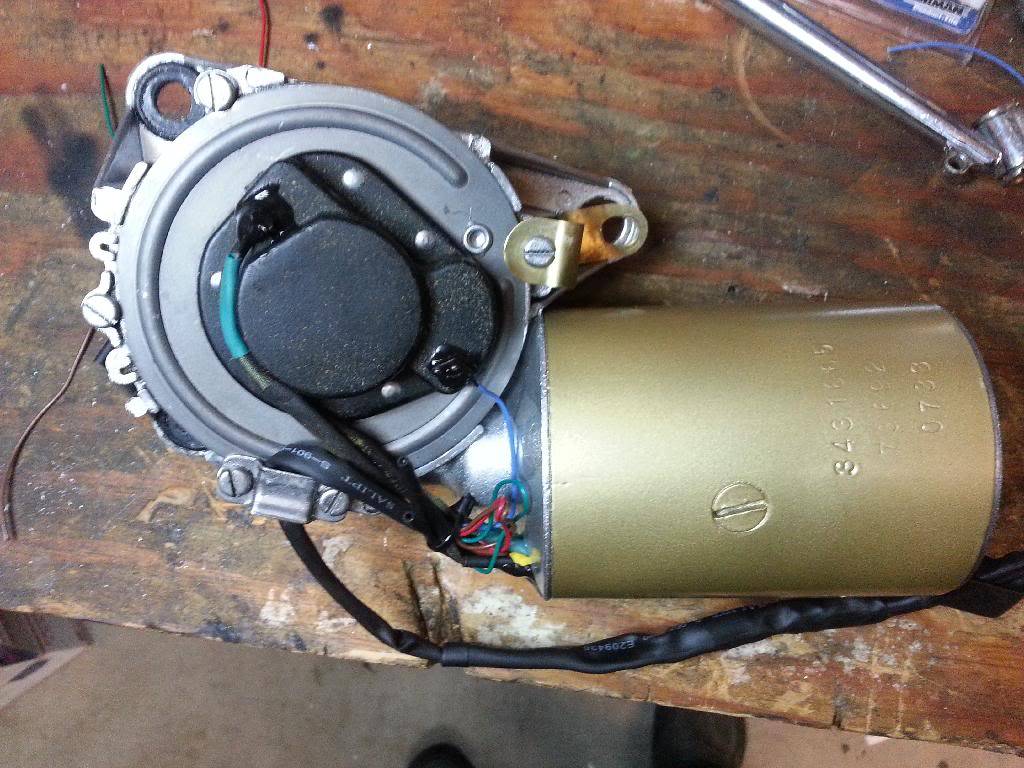

I have a 73 2 speed motor in my 69 so if you need assistance let me know refreshed mine and figured out how to clock it for the park position. Also if you want to have your OEM rebuilt send it to Kim at passion4mopars.com they are the best and most helpful. Not sure why on mine but someone had cut one of the wires. Rebuilding it is easier than you think if it even moves now all you need to do is refresh it. I can walk you though it.
What is the correct color for the wiper motor? Seen some black and others plated(?) like a new starter motor.
Anodized yellow / gold color.
