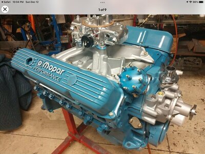

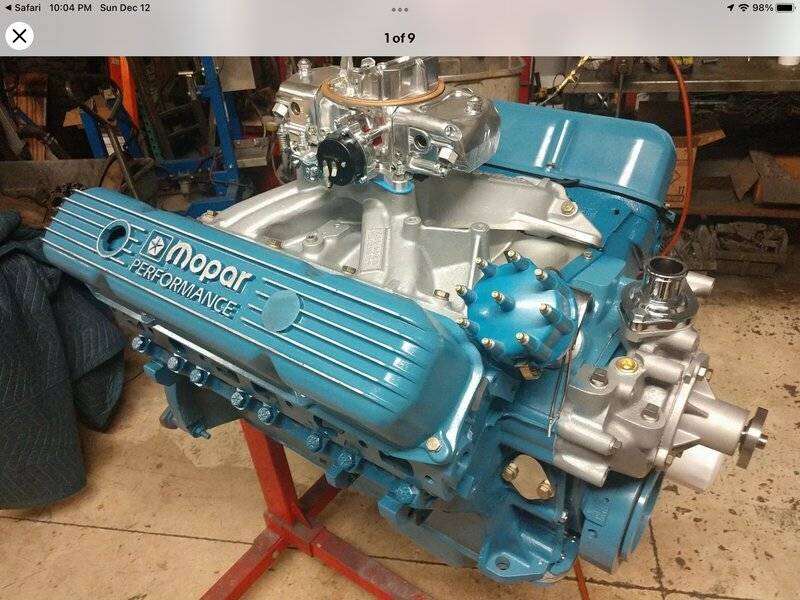

Here’s a picture of a motor that’s been Balanced & Blue Painted.
