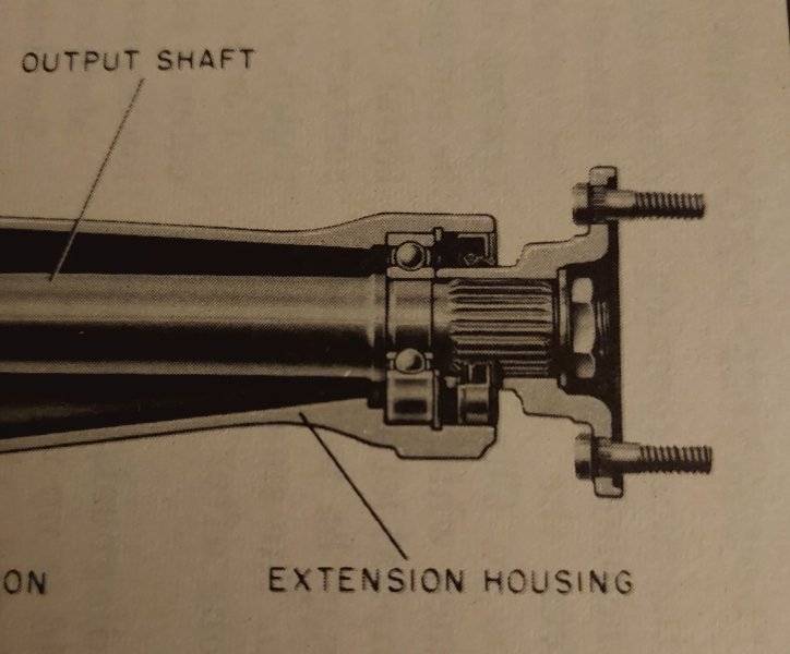

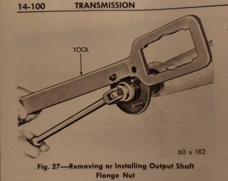

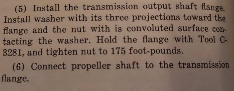

Here's what the Factory Service Manual shows...
Don't fret about the 175 ft lbs. 100-125 should be good. Could be the orientation of the washer? Make sure the transmission isn't overfilled.
Put some Loctite 567 Pipe sealant on BOTH sides of the washer, & also on the threads. Make sure the area is thoroughly dry, wipe with lacquer thinner. Those are the areas that can get leakage & this will stop it.
Thanks, This car sits alot, and over the winter also. Maybe with the converter draining back the overfill condition maybe the cause.
