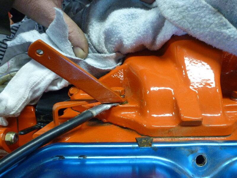

Does anyone know we’re the negative cable connected on a 1969 super bee thanks
Under the throttle spring bracket. To be OE correct there shouldn't be a washer under the bolt head! The correct cable's end is formed specifically to work in this situation.
To be correct, the cable is painted the engine color also.
However, if you have a Hemi, the cable will attach to the front head bolt hole.
