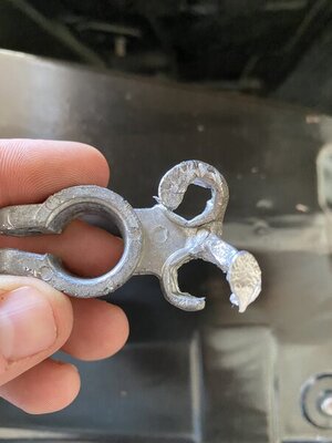

Battery connections melted.

Updated... I replaced all of the connectors with high quality battery terminals and tightened all of the ground connections. Thank you for the help!!

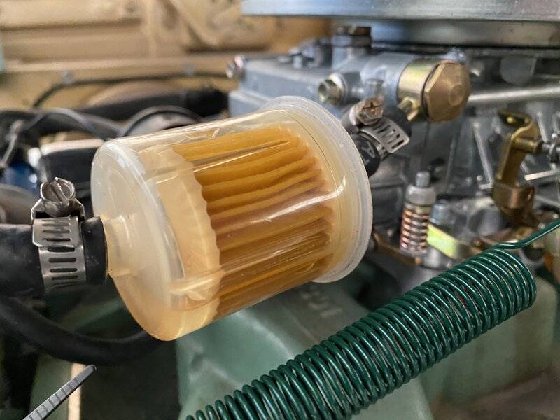

^^^Next question, should my fuel filter carry more fuel than this normally? Seems like it should ?
