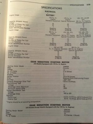

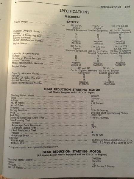

Hope this helps.....Service Manual Pg 8-99, SM doesn’t indicate if standard/special equipment pertains to air conditioning though....ever get your engine in...Jim

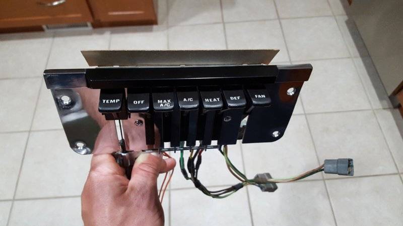

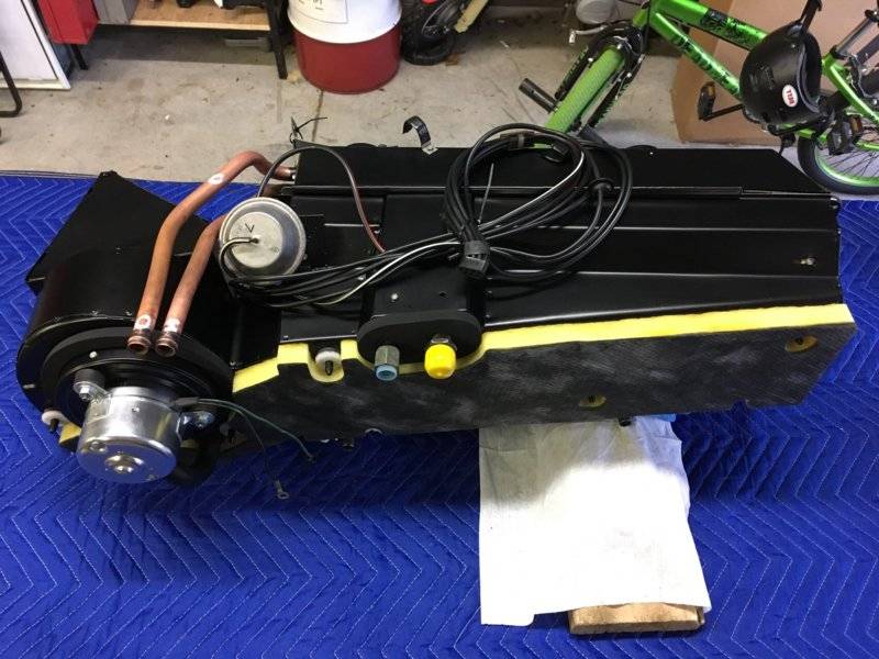

Hi Ranger16, H51 was the option code for ac in 69. Here is a pic of the heater box and the ac control switches. Hopefully Moparnation74 chimes in.

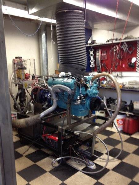

Drop top is correct all 69 RR 383 engines with ac where turquoise. Air grabber was also not an option with ac. Here is an older pic of my engine in turquoise.
