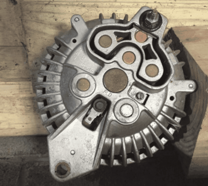

the rusty circle in the center of this photo is the rear armature bearing. It becomes magnetic when the alternator is being spun by the running motor and a field test is to touch some steel to it. Take care to not touch anything else.
I touched that part with a screwdriver when the engine was off and I did feel a slight magnetic pull.
WRONG.....it is the rear rotor bearing, not armature bearing, and is totally isolated from the rotor's magnetic field by design. Any current that would be present would cause the bearing to fail due to shaft current flowing thru the bearing to ground. If you suspect a grounded rotating field windings, measure the resistance to ground thru either slip ring to the shaft using a high resistance megohmeter.....it should be infinite....no resistance.
