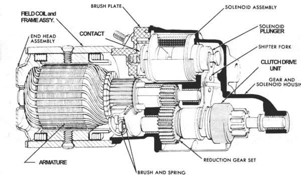

gives you an idea why the solenoid on the starter needs power to operate.

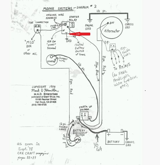

I thought you said you already ran a 1/0 awg to the starter? It would need to connect to the starter solenoid post as in this pic. I'd lose the ford solenoid, I think you've basically added a second relay...
just to clarify, the post on this solenoid is a connection point where the starter's braided wire picks up it's power from. The solenoid operates by a signal through the smaller wire from the relay on the firewall.
Glenwood, this helps big time. I know where the terminal is on the solenoid. And I know where battery power is on the relay. What size wire do I run to the solenoid?
battery + to starter (solenoid post) 1/0awg imo
battery - to frame 1/0awg imo
frame to engine 1/0awg imo
Relay batt post (shared with alt) to battery + 8awg or really could just connect to the1/0awg on the starter solenoid post

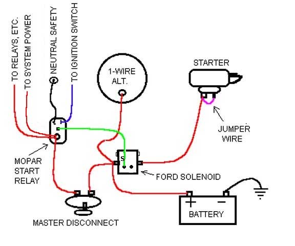

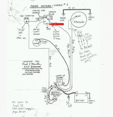

This is how I did the challenger, worked great. is the car a four speed
Here is another pic
this diagram would work since the solenoid and starter motor are supplied power at the same time from the external ford solenoid or relay.
