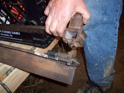

don`t shoot me I found this maybe it will help you

Pirated image off the internet.
plywood and a router. then get creative with a grinder and a air chisel hammer bit. I got this off the internet , think from the jalopy journal. but it worked for me.
18 gauge is easy to form. Dies can be made from anything hard. Apparently Russian plywood is hard enough to make multiple use dies but for a one-shot deal you could probably use pieces of oak. The real trick if you plan to "press" the metal is getting it to press evenly.
