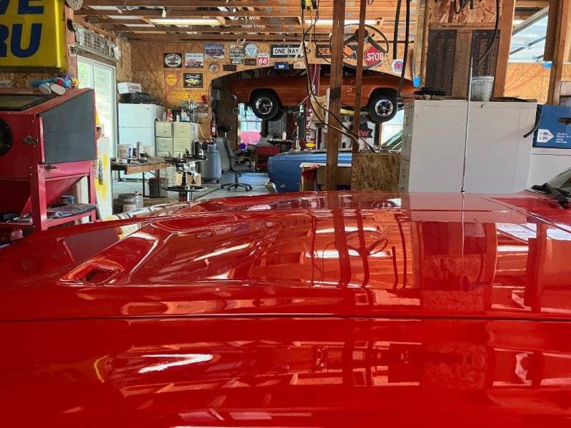

I like keeping everything under the stock hood so that means no TF 270s and the matching single plane high rise intake. Given that, the TF 240s with my Performer RPM intake limits what gains I could have. I'm already close to the hood now.
Nice paint!
