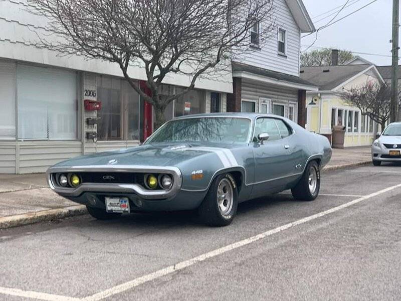

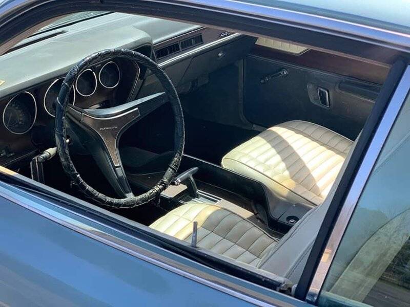

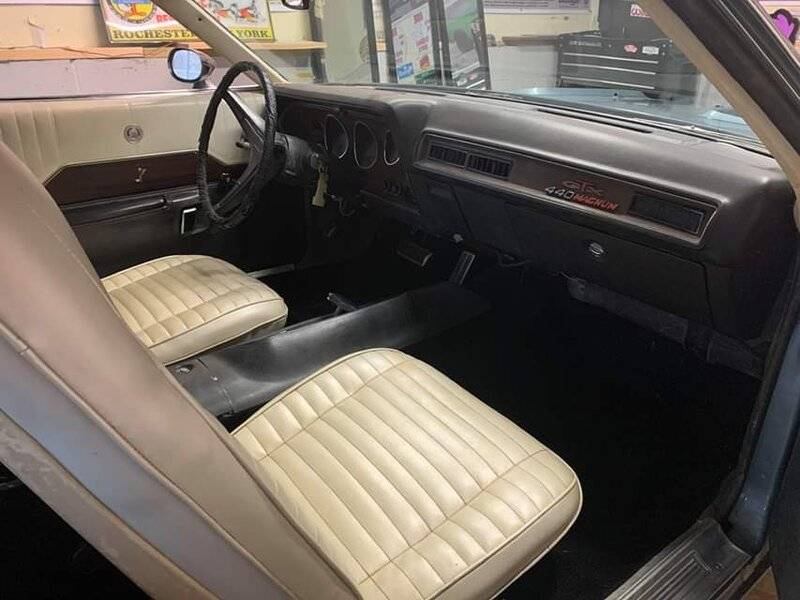

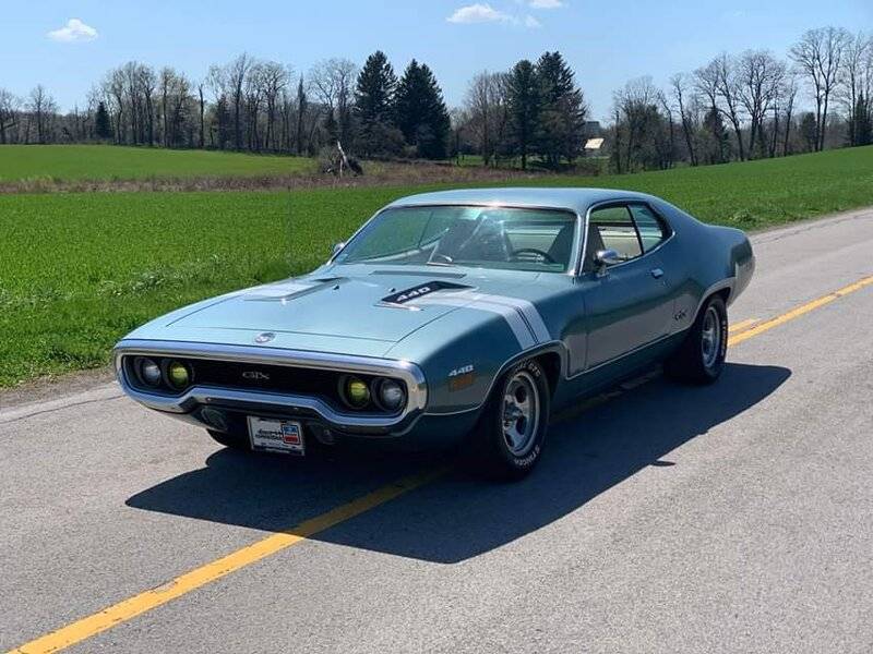

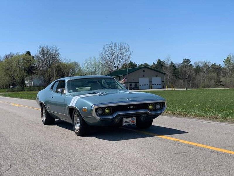

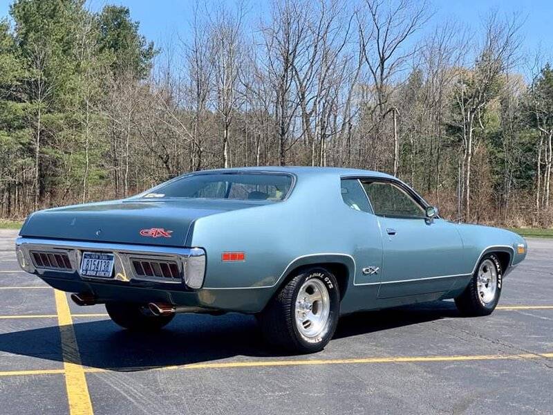

Been a member for a while, on the 18th I will have a car!
