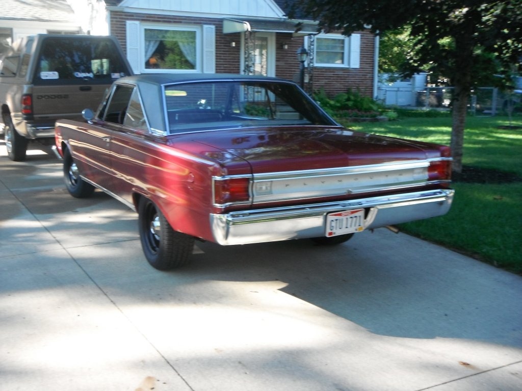

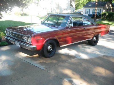

Been busy the past two and a half weeks, on the Plymouth.
Auggie56
5:07 AM
Nov 14, 2011
9,442
18,711
NW Ohio
Got a pair of 7x15 steel rims for the front, and 8x15s for the rears. I can't recall the size of tires, but they are all twenty eight inches in diameter, fifties in front and sixties on rear. Rebuilt the front end. A disk brake kit on front. Swapped out the rear end for an eight and three quarter, three twenty six ratio. And new pair of rear shocks. Gotta take it in for a front end alignment. Closer to next spring, I'm replacing the torsion bar anchor (rusty been repaired once), torsion bars and the lower control arm bushings. A rebuilt power steering box is in along the way. That pretty much takes care of the chassis. I'm pretty pleased on how she sits now. Rebuilding a 440 and trans, to replace the 318 drive train as the money permits.

Right now the camber and caster both are way off. I don't want to ruin the new tires, as I plan on driving it more this fall.

Looks great Auggie!
Big MOD
Great improvement!
I love that way it looks now.
Also, the TT1 and the Black Vinyl top combo looks great!

This I know is a possibility. I have my hopes it will line up, so I don't have to lower the front end, to bring into spects. She sits now just how I like it. Thanks for your input.
