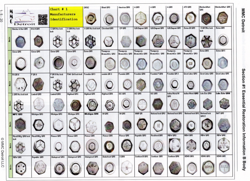

I would like to understand the different letters on the heads of the bolts for my 67 GTX. I noticed 2 different ones that are used in the front end. One has a G over and L. The other has a N and L attached to each other. Is there anyone out there that can explain?
Like dadsbee said, manufacturer mark.
I believe the GL is for Great Lakes Fasteners. NL National Lock Fasteners.
(Credit: David Wise, book ‘Guide to B Body Fasteners-1968-70)
There are two pages of bolt markings in the MCC restoration guide:
Do certain bolts go on certain pieces? On my car, the GL bolts fasten the Stone Shield, while the NL fasten most everything else up front.
It's mostly the year, but also can be the plant.
Not really its simply luck of the draw. Bolts were thrown in a bin and pulled out as needed
Said bins were replenished as needed with which ever suppliers box was next in line
Head markings were to simply to identify the manufacturer of said fastener , mostly in case if the Auto manufactures should see an excessive failure rate they know who to go back to
