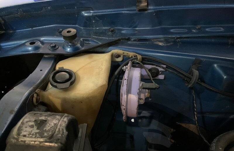

Nope, not correct at all for 71. Photo of my original car for reference. Can't speak to whether 73 is different
Nope, not correct at all for 71. Photo of my original car for reference. Can't speak to whether 73 is different View attachment 1063453
The '73 RR I'm working on looks quite a bit different than this. There's a fuel vapor canister in the corner where the plastic bottle on your car is and right behind it is where the fuel vapor line comes up from the gas tank, so the horn couldn't mount there. Also the horn that came with my car has a different mounting bracket. On my car there are two holes - one small and one a little larger - on top of the front of the inner fender structure just forward of the radiator support, so I've thought the horn mounts right underneath those holes (which are for the mounting bolt and locating tab of the horn bracket?). This would put the horn in back of the headlight, pretty much out of view. I don't even think Plymouth bothered to put a decal on my horn as there wasn't any indication it ever had one on it before I repainted it, since it wouldn't be visible anyway. The horn was still painted the unique violet color though.
The reason I thought the horn might mount n the left side is because when you mount it to the right side as I previously explained the electrical terminal on the horn points toward the front, away from the wiring harness. The lead coming off of the harness is plenty long enough to still be plugged in the terminal on the horn though, I think.

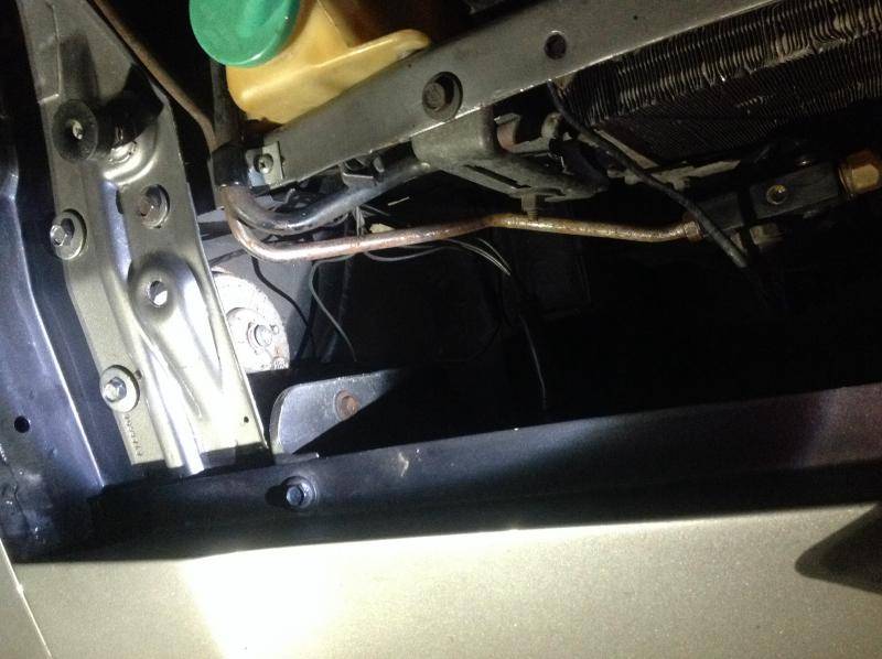

1972 is not in the same location as 1971. In 72 the charcoal canister is mounted where the horn is on the 71. The horn on 72's goes in the space between the bumper and core support. Not sure about 73-74's.
