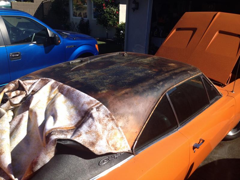

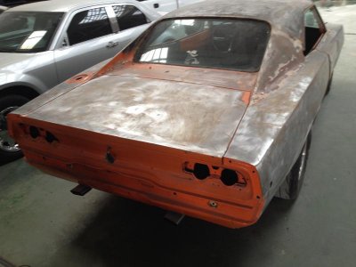

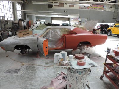

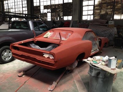

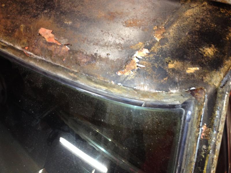

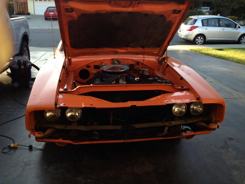

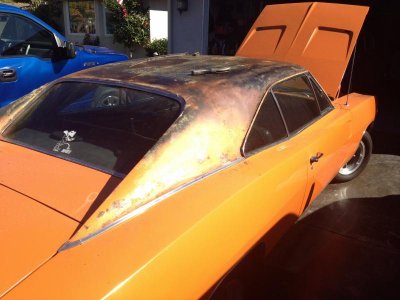

I am in the early stages of tearing my car down getting ready for paint. When it gets painted I plan on replacing the entire wiring harness. The car is in decent shape (I think) so I am hoping for a 6 month eta for completion. It has a 360 stroker 410ci with a 4 speed. The engine is done and the interior is pretty solid. I am not doing a frame off as it is a driver. I enjoy getting the rubber on the road. I would love recommendations on where to look for parts.
Where should I look for a good wiring harness that I may be able to install myself.
I am preparing the car for my Son. Rangers Lead the Way!
Thanks All

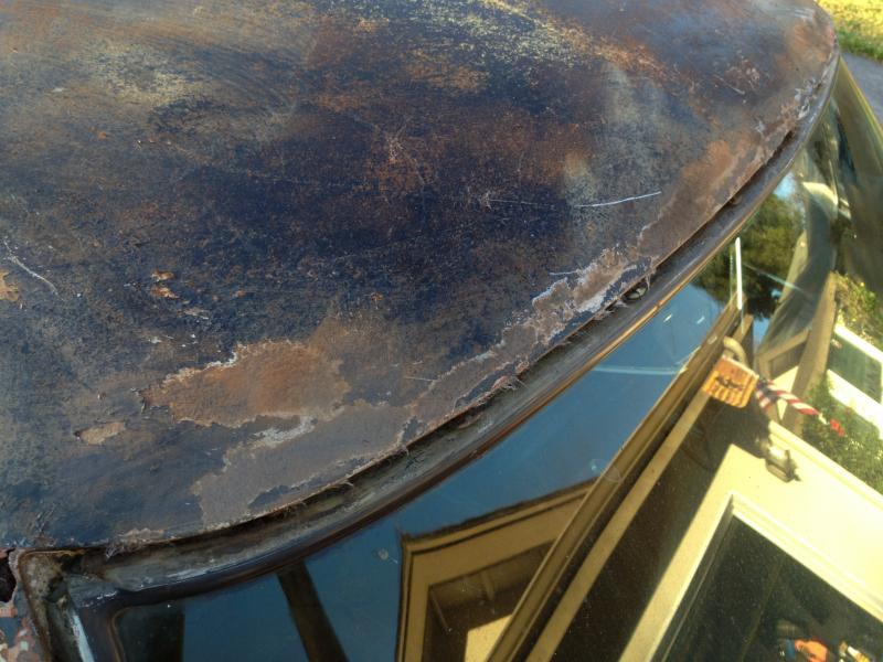

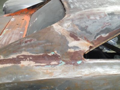

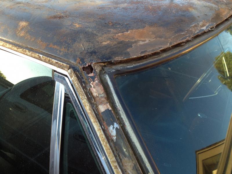

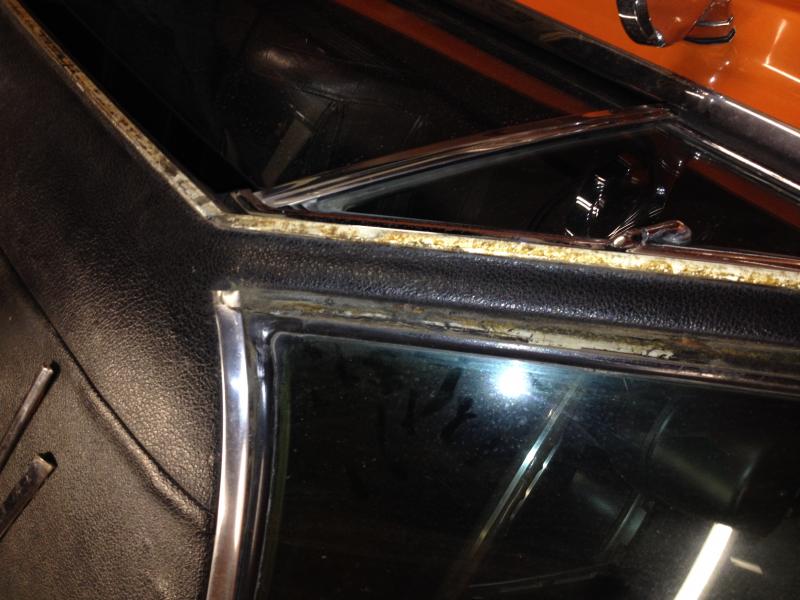

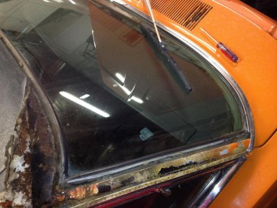

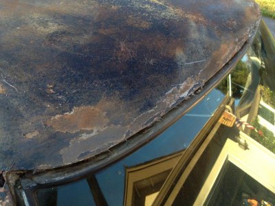

Damn them vinyl tops.Good luck with your project. Glad you decided not to do a frame off resto too. lol

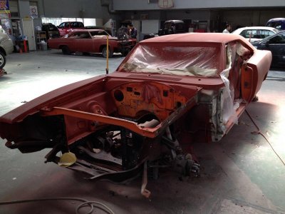

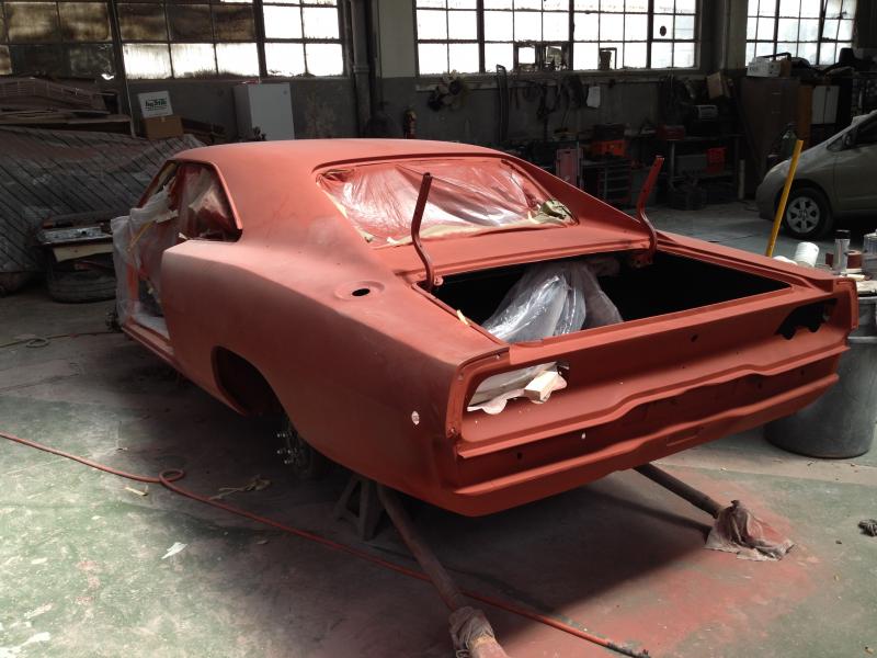

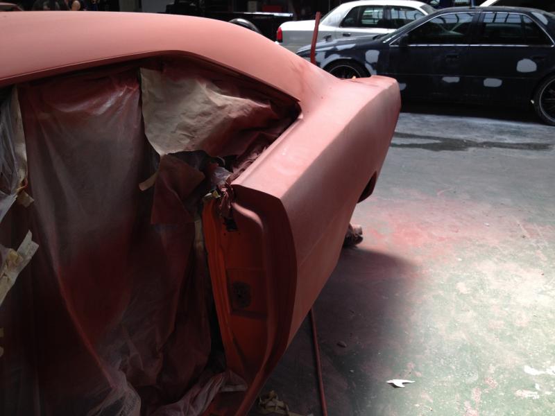

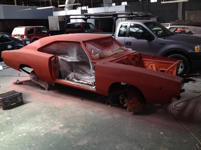

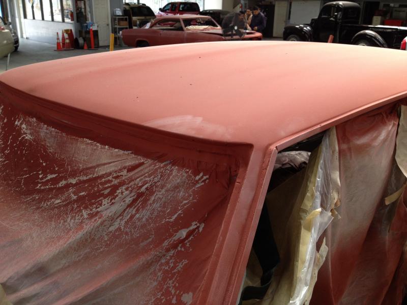

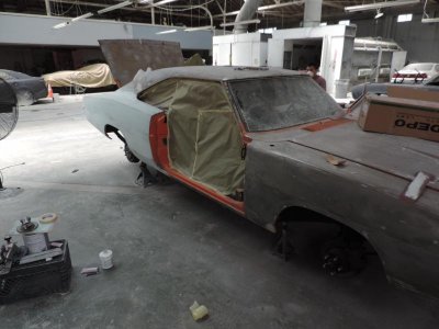

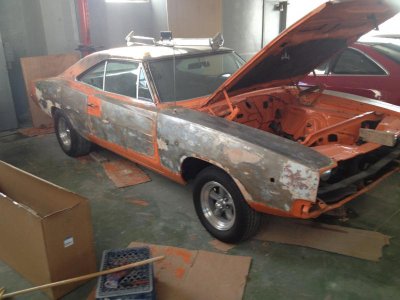

Though I would post some photos. Getting ready for paint next week.1.jpg5.jpg9.jpg10.jpg11.jpgDSCN0243.jpgDSCN0244.jpgDSCN0245.jpgDSCN0252.jpgDSCN0254.jpg
