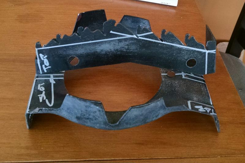

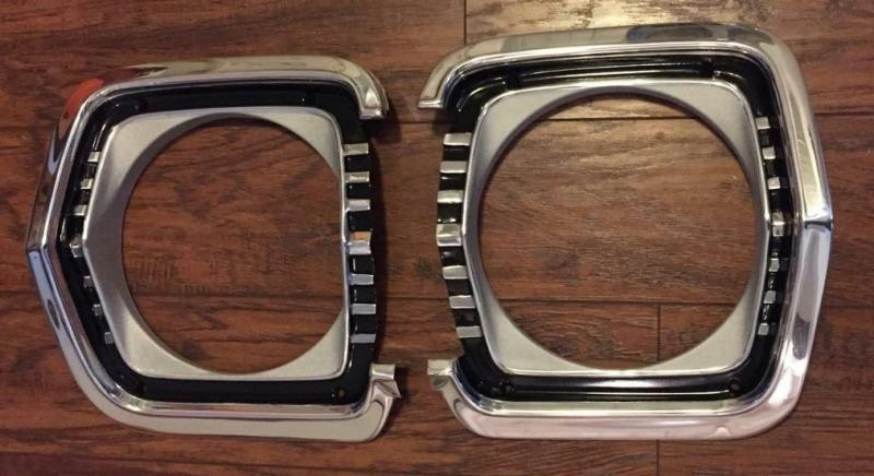

The h/l bezels are polished and will get painted tomorrow. Then the hood lip molding is next. Then is tricky part of putting Gary's idea into motion, although he did send me pics of how to cut the brackets. Welding the aluminum will be dicey as it is thin, but it's doable.
Braccket Mods

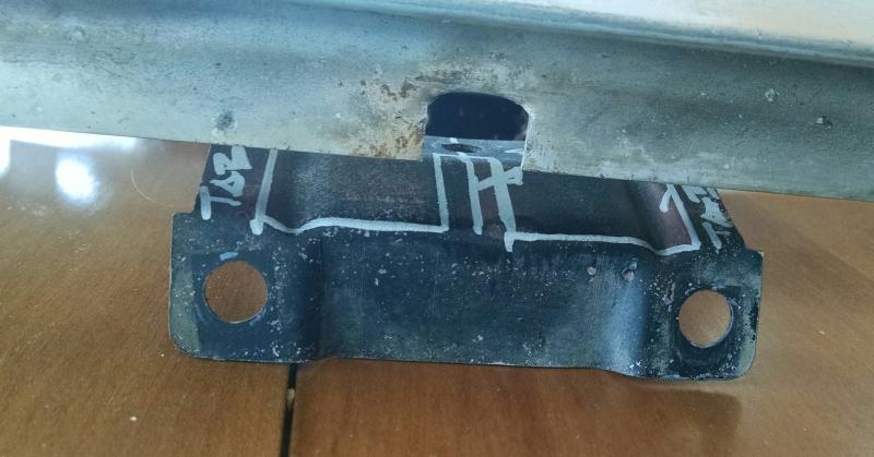

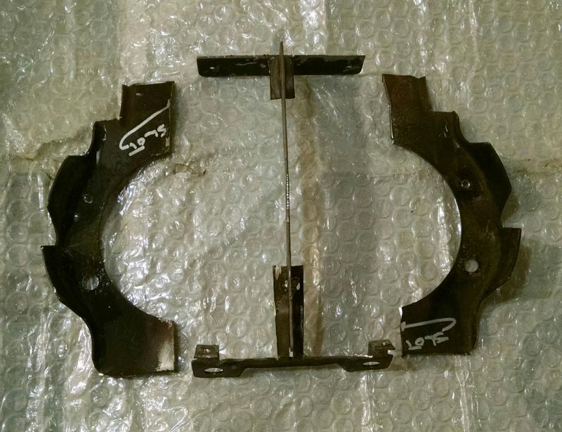

The grille/ parking light brackets have to be modified in order to use them to mount the grille in the original position in the upper and lower valance. Just in case you have just tuned in I have removed the parking lights to make a S/S style grille.
The tabs will bent forward and rest underneath the lower grille bar the drilled and riveted in place.
She's a little rough around the edges but I think you get the idea!!!

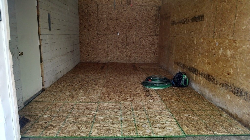

I have rented a storage(11x20)unit just down the street and around the corner literally. It is convenient and I can use my JD/ yard trailer to transport the goods. I have it all prepped and ready to rock!!!
I think this is going to keep things nice and dry!!!
