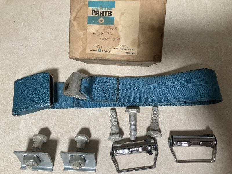

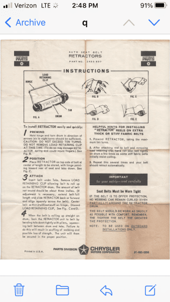

I came across this little box of seatbelt items for a dollar, so I grabbed them. Included in the box was a sheet with instructions on how to use the retractors. For anyone who has had problems Getting retractors to work properly, here is that instruction sheet. I am not sure what the two little brackets with the weld nuts are for. I am guessing they are for installation in a car that didn’t come from the factory with belts.
