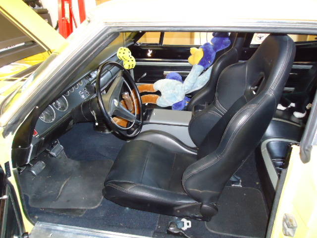

I did the same swap a few years ago. I put it at the height I wanted using wood blocks first and used a level to get it right side to side.Cut some steel tubing from the hardware store for spacers with flat washers top and bottom.
