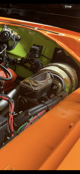

I have some questions regarding Bendix’s boosters. My card originally came with front disc, brakes rear drum and manual master cylinder. I bought an aftermarket master cylinder and brake booster. I think it’s a 7 inch. I’ve been told that 8 inch boosters worked better. Mine I have to push pretty hard on to get the performance I want. I’m getting around 10 Hg.

The gold one in the car is my current 7” unit.
Dual diaphragm boosters produce more output force than a single. Similarly, a bigger diam produces more force than a smaller diam.
I have read about those cad plated China ones giving trouble for folks after a couple of years. I sent my Bendix to Booster Dewey ( not the actual business name ) in Oregon ( now Washington State ) for a rebuild, super happy with the results.
