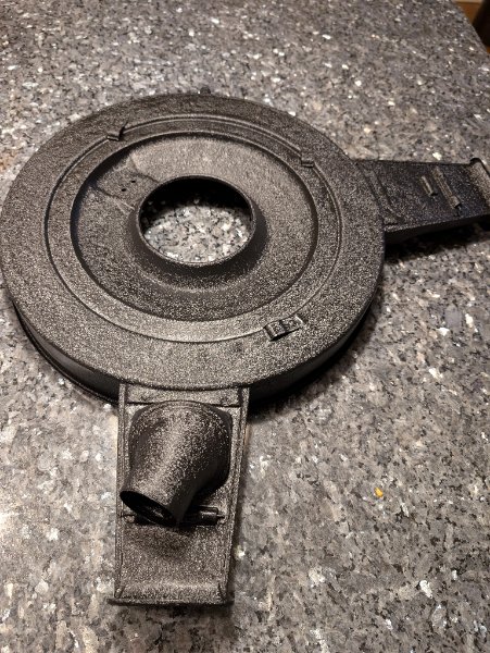

I'm looking to refinish my dual snorkel air cleaner on my 1970 Charger R/T. It has the black crinkle finish paint and some of the original paint looks like it was sprayed off with a pressure washer over the years. What have people had the most success with in refinishing these?
Thanks in advance!

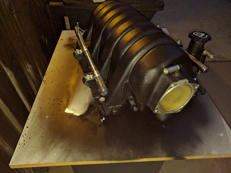

I havent done an air cleaner but I did a 6.1 hemi intake with VHT black wrinkle plus high heat.

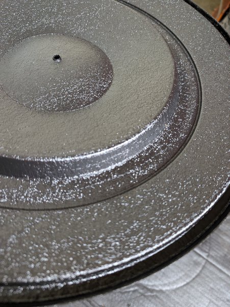

On another thread here recently I asked about wrinkling but in non-black colors. The solution I tried worked out fine was the standard wrinkle black, followed after wrinkling by a light coat of the color of choice. It surprised me how well it came out and was relatively easy.
Not sure yet how it will wear.
