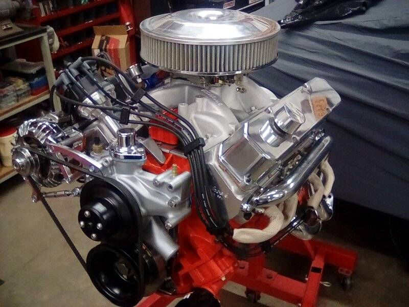

Victor MW heads on a 400 low deck block. I'll see if I have a photo when I get home.
