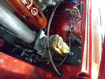

My 62 Belvedere set up with 4 wheel Willwood Discs. Made heat shield that drops temp by 80%. 15/16" MC bore for correct pedal travel and effort.
