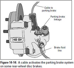

provides a better brake to use as an emergency, rather than a parking, brake. I've never had rear discs, how does the EB work on them? Does it use the brake system's hydraulics, specifically the master cylinder, or is there a manual cable that somehow applies pressure to the pads?

The link shows parking brake is 'caliper integrated', so it should be very good. Newer cars have the rear disc parking brake as a miniature drum brake, and it is not very good.
Having said all that I would think the drum parking brake would be adequate at stopping the car at slow speeds, but I'm not certain a disc caliper parking brake would be much more effective.
Your original factory set-up should be enough. Might even want to check the cable, tension on the cable but should be good. I'd save the $$$ IMHO to spend on something else.

On the '69 Coronet, I recently converted to cheap 4 wheel disk brakes (Right stuff kit) and the rear caliper has the E-brake setup as shown.

Emer. bros are iffy at best because of weight over rear of car but they are almost exactly as hard working as when using foot brakes. They'll stop but not nearly as good as with fronts working. Think weight transfer as it always heads towards front end when stopping.
Well I got everything buttoned up and adjusted correctly. You're right, they will stop you, if you have some room in front of you. The cool thing on a 65 Coronet is the brake release is in the dash, pretty much where the headlight switch is on most cars. So it's easy to reach and pull when you need to use the e-brake as a brake.
