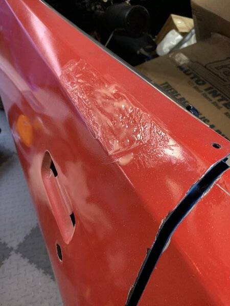

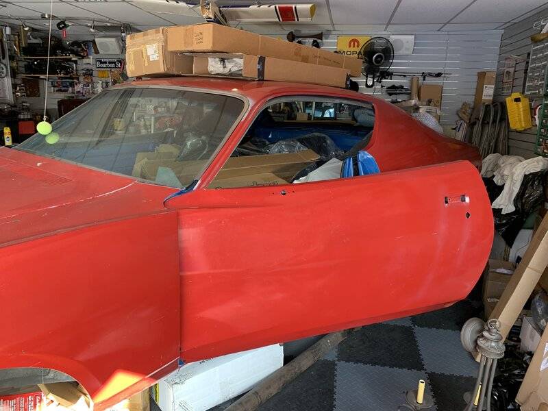

As I was rebuilding the door inners, I decided to rust protect the paint inside the door, and then add sound deadening, and then I thought why not strip the paint off the exterior of the door and prep for new paint.
The existing red is a rattle can protection added a while ago.
Would love to do this all inside the garage... I figure I’ll focus on parts at a time.
What would be best to easily remove the existing paint without taking it out and sand blasting (which I don’t have)?

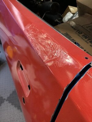

This stuff works great. Work in a well ventilated area, wear gloves and goggles... It burns! I found that applying it then power washing it off works the best but is messy, typically you apply it then scrape the paint off with a puddy knife. I use a paint brush to apply then keep adding it where you see it absorbing it until it's all wet... within a few minutes the paint will turn to slime. If there's multiple layers it may take a few applications.

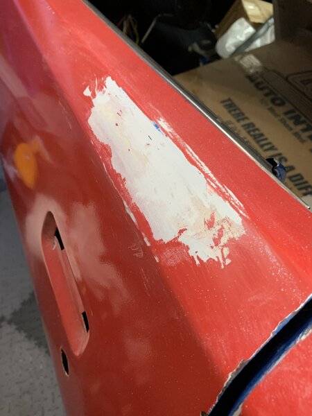

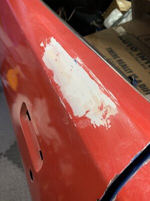

Citristrip, 15-20 minutes. Used a plastic putty knife and it came off like plastic pieces. Thanks for the ideas!
